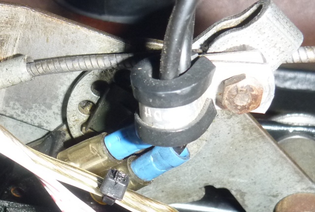

It sounds like the pull knob is out (on position) and movement left or right interrupts the circuit or breaks it, probably indicating a broken wire at the back of the heater control.
Bob
Had a similar problem. Crimped new ends on the wires and added a p-clamp reinforcement to the swivel for the heater control:
attachment.php
