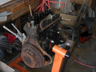

Jim, this is what I did to mount my 1275. Three bolts, one from the dist. mount, one from the generator bracket, and one from the oil filter mount. It was a little off center, but worked ok.
Scott in CA.

Jimflorida
Thanks, Scott. I think I have the same stand. Will give it a try. Jim
