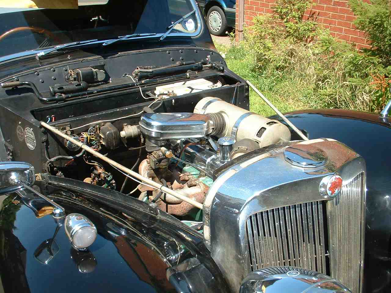

"In fact, as fas as I know, all Triumph engines seemed to be black" I'll throw in a curve ball. In my research on my car I've found out that in the 1949 roadster green (similar to buick green)was used as an engine color. Another Triumph /ubbthreads/images/graemlins/england.gifpost-war oddity.

Alan_Myers
Good point, Paul.
I should have limited my statement to TRs and a few other models that were widely sold in the U.S. from around the mid-1950s through mid-1970s... i.e., what I'm most familiar with.
Yours is a great looking car, by the way. I always really liked the roadsters' styling and features. The "rumble seat" is especially cool!
/ubbthreads/images/graemlins/cheers.gif
apbos
Allen
I bow to the master /ubbthreads/images/graemlins/yesnod.gif. But, I cannot claim ownership of the vehicles in my post or my avatar. My avatar picture is what I believe to be the perfect example of a Lumina Green TR. In 1949 the TRA was available in for colors, Black, Lumina Green, Lumina Champange and Lumina Grey. My car came from Coventry; Lumina Green. You can see pictures of my restoration to date at https://pg.photos.yahoo.com/ph/paulbos@sb.../ph//my_photos. 5 months into a 2 year restoration
Paul
