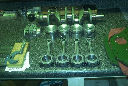

Well, I have not had much time to post here lately, but wanted to give a update on Drew's motor. The block,has been cleaned, bored .040" over, the line bore was right on the money, so that did not have to be done, the crankshaft, was pretty nice, after I magnafluxed it and straight check it for run out, I then polished it, and it turned out great and was able to stay standard/standard. The crankshaft was then balanced, from the factory it was 1.5 grams out on the front, and 4.4 grams out on the back, now it .6 grams on the front, and .5 grams on the rear. The connecting rods were then cleaned, bead blasted,, parting line cut on the Sunnen cap grinder, the new ARP rod bolts installed, then the big end sizes to my spec. Then the rods were balanced, from the factory the rods were out about 4 grams top and bottom, now the rods are all with +/- 1 grams, top, botom and total weight. The entire rotating asembly is blue printed from one end to the other, the rod and main clearences are set on .0015". The piston to clyinder wall clearence is .0025" to The AE21253 piston were good as far as balance right out of the box, all within 1 gram of each other, the pin bore as for clearence were all good as well. The next thing I'll do is check the gaps on the ring and adjust them as needed, then get the piston pressed on the rods. Here's some pics of Drew's motor in progress.

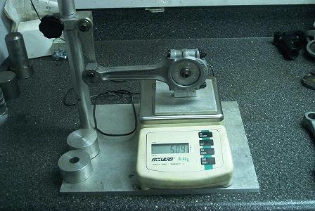

Here's a picture of one of the connecting rods having it's big end weight checked.

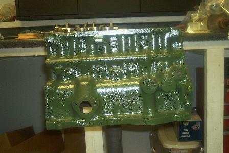

Here's one of the block awaiting all those all those nice prepped parts to be inserted into it.

A little more about the recipe for this engine. I'm using AE 21253 psitons, instead of the AE21251 piston, because the AE21253 has a higher compression height, and with a skim ust on the head I can get to right under 10.0 to 1 on compression ratio. I'm using APT VP276 cam which is pretty much the same as the Kent MD276, I'm suning APT CF-04 chilled iron lifters as well. The cam David Anton ground for me is done off a late model Mini slot drive oil pump core ( of course we're using the later slot drive oil pump as well), then it's Ion nitrited after grinding, so the lifter and cam are both around 57-60 Rockwell C hardness range, right where you want to be, we'll be timing the cam with a Rollmaster adjustable vernier cam gear set. I'll be advancing the VP276 cam a few degrees to give Drew plenty of grunt. The head will be fully ported and polished. All ARP hardware thru out, everything balanced. This formula ought to net Drew a honest 100 hp.
