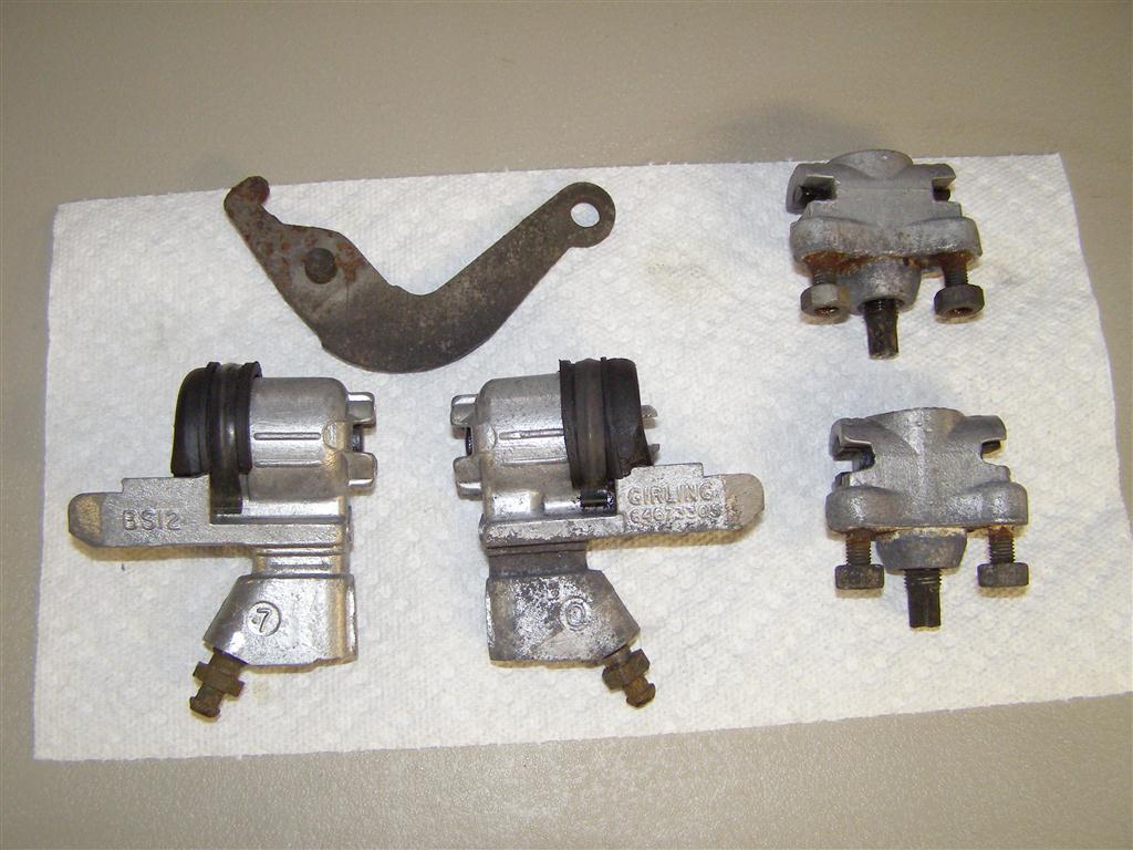

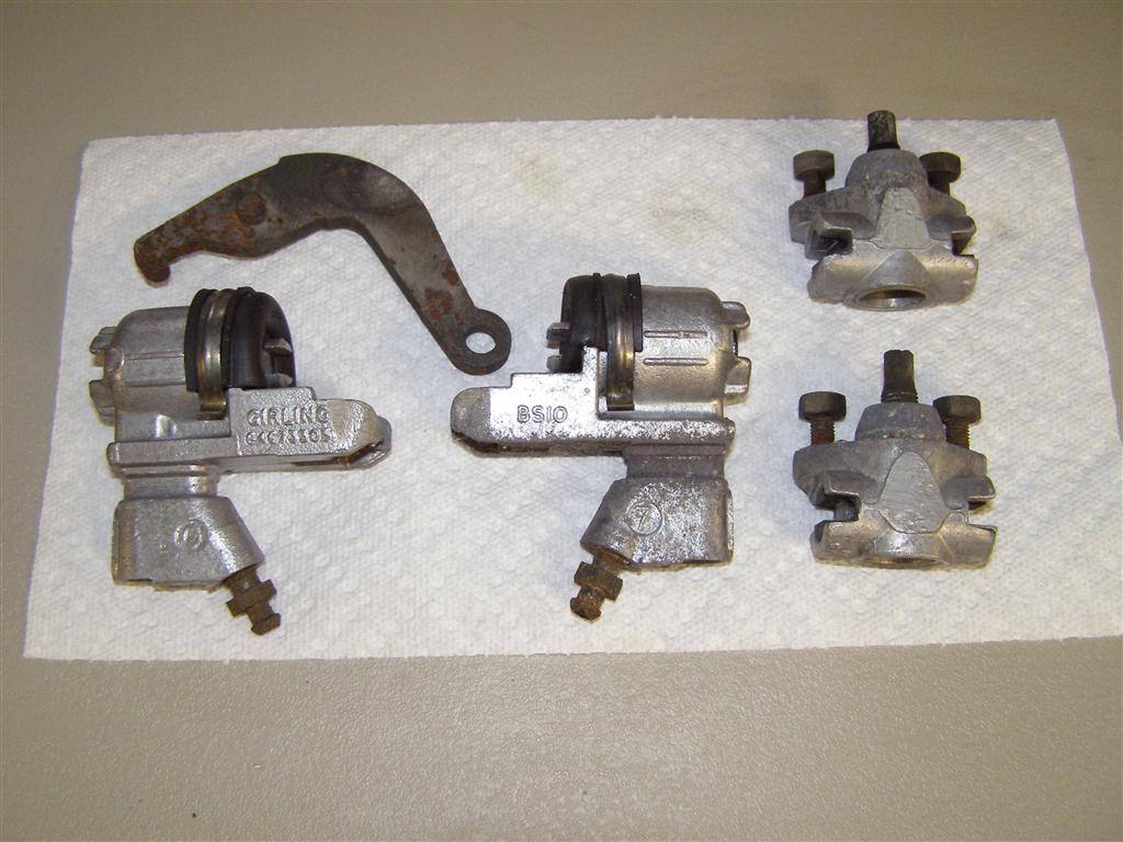

Since our good friend TR6Harris posted the tip about CLR, I've been spending time salvaging parts to refurbish. The heater valve kicked it off and then I decided to try it on a hood support rod for my TR8 that I got which was all pitted and rusty looking. That cleaned up really well after soaking for 30 hours in 50'50 mix. I did not take before pics, but it was not very pretty when I started. This has not been polished yet.

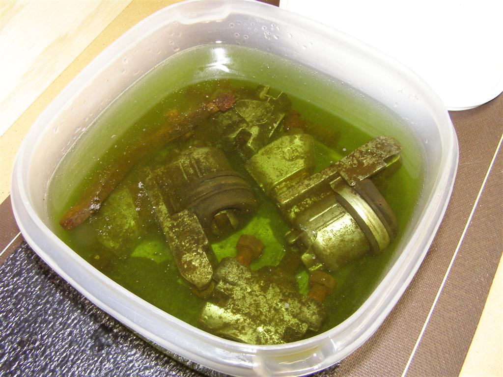

Then I dug out the backing plates that I had on my for sale list and took off 4 complete original Girling rear brake adjusters which are all apart and now soaking away. I took one out for a quick look and it's coming along nicely. I will strike the plates off of my for sale list and just sell these on eBay after I finish cleaning them up nicely. This mix is 50/50 and has been soaking for about six hours. We'll see what they look like tomorrow.
And I found two other plates that had original wheel cylinders attached and two original adjusters, but I can't find the Girling name on them yet. I'll degrease these then soak them down for a day or so.
EDIT: These did NOT come off my original car. Those parts are all packed away, for what I don't know, but they are. This was all eBay buying fits of days gone by.

She probably will after you see these. I got really lazy the other night and just dropped those really dirty, rusty wheel cylinders and brake adjusters into a 60/40 mix and left it sit for 30 hours. It was really stinky when I uncapped the plastic tub, but this is how they came out after a hot water and toothbrush scrub rinse.
