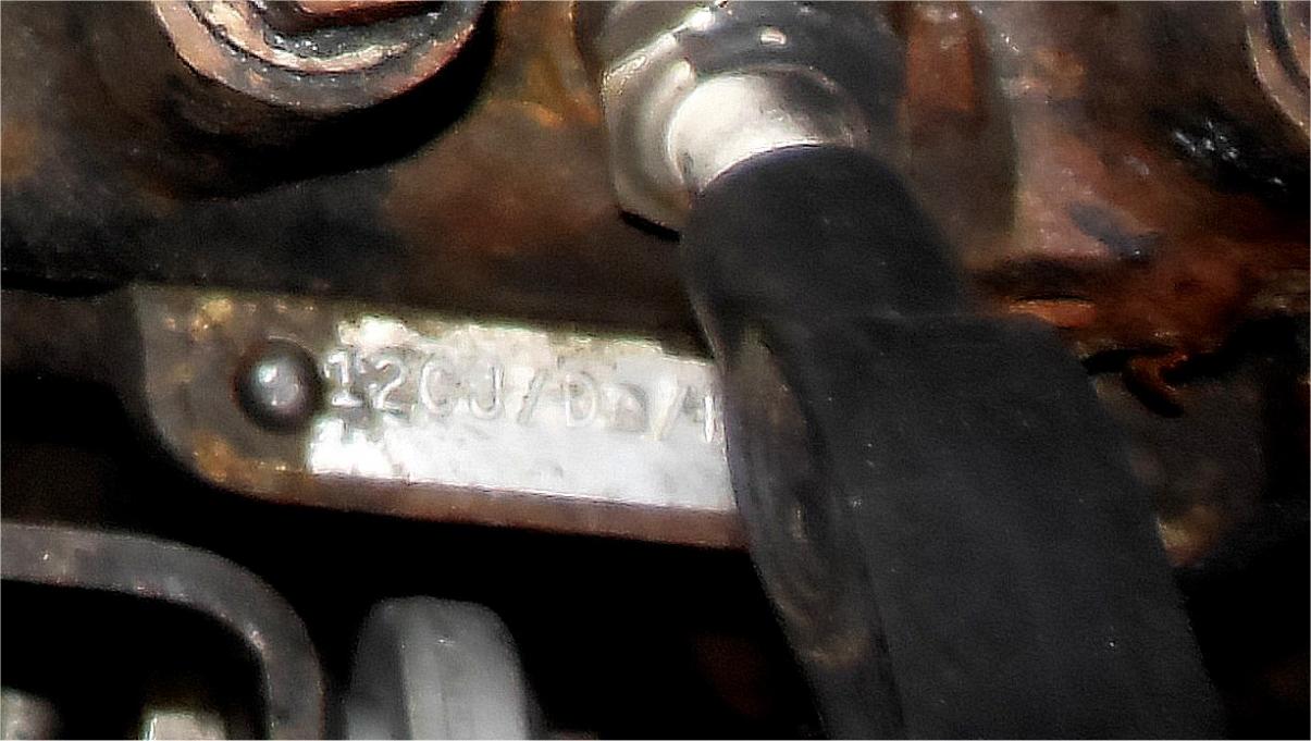

He sent along the engine tag numbers, he said it reads: "12CJ/DA/H 40507".
Here is a fuzzy partial image, don't know why he didn't try to get that better.
