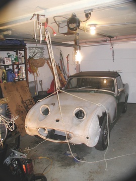

Or you can set up a one person method with a pulley and lines going to fender mirrors. I do have mine set up as a forward tilt bonnet and I rigged pulley up to an overhead beam. I see ads for Space saving rope and pulley systems to suspend bikes, other items from the ceiling i.e. Spridget Hardtops. Same sort of thing can be adapted. I had some spare sailing hardware I repurposed. Now I would not want to pay retail for those Harken Blocks Blocks and Mainsteet Cleat I repurposed but something simple can be rigged up to allow you to handle by yourself.
Two at minimum would be better to do this job even with my system.
