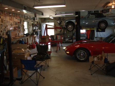

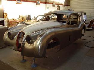

If it has wheels (preferably 4) and a motor I like it. Attached are some pics of the things that keep the vital juices flowing. About the octane, I have never run anything less than 91 octane in my Healey. I think I have the high speed cam in my Healey from the previous owner. I runs well on 91.
Red Vette is an original 350/350 hp with 11:1 compression and it definately does not like 89 octane. It will ping alittle at high rpms, and then deisel when you shut it off. With 91 or higher it has none of those problems. Dave. Oh, I should mention, there are a couple of fishing rods over in the corner of the shop. :smile:
