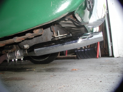

Installed

That looks nice!
Jim, it's kind of funny.. You see so many car pictures on the net with the license plate blurred.. Your plate is your avatar! :smile:
