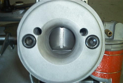

Here's the deal you use your two stock aluminum factory velocity stacks that are normally hidden in side the stock "tea pot" air filter cans, and bolt the factory velocity stack directly to the carb body, I counter bored my two mounting holes to give it flush mount, but you can use hex bolts or button head allen bolts with no mods to the stock velocity stack (not use no gasket between the carb and v-stack), Then buy 2 K&N RU-4410 air filters, which has a rubber mounting sleeve that is exactly 3.5" ID (the same as the OD on the stock velocity stack) so the air filters just slip over the OD of the v-stack and is held on with the supplied (with the KN filter) clamp. It doesn't getting any easier and better performing than this.
Here's why I did this Art, when I got my car it that this blingy front plate back plate set up on the with threaded rod running thru the air flow of the air filter, like almost every stock and aftermarket set up offered for our cars, which are a absolute PITA to remove and work on the carbs. Sure some of these set up are very blingy, but I wanted perforamcne and ease to work on, not bling, most people like the looks of it because it looks racey, but for me it was always about performance and easy to work on.
Here's a a couple of pictures, one is of the filters installed, the other is of the factory v-stack showing how I counterbored the stack to get a flush mount on the carb.

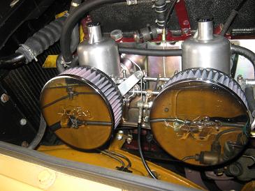

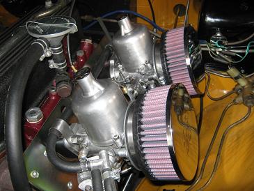

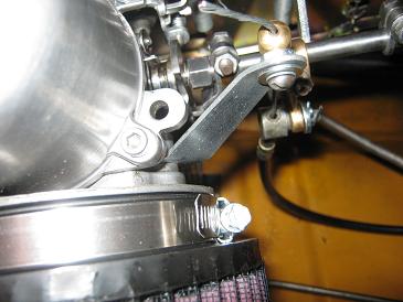

Ray, before I give you a bum steer....the correct part number is RC-4230. These are the 2" high version. I sent the RC 1790 back as they looked too tall. The cost was $44 each. The K&N people were very helpful. I've attached some pix's of the setup.

Okay thanks for the heads up Ralph. I'm curious though, did the taller ones fit okay? any clearance problems or did you just like the look of the shorter ones better? I liked the idea of the taller ones thinking more air rom for more air coming in etc etc.

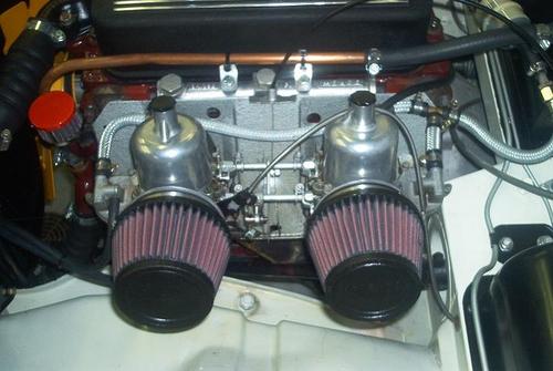

The RC-1790's were too tall, the front carb had the interference issue. But, it was real close. When I look at my current set up vs. the original air cleaner set up I'm light years ahead. Hap can tell you which tapered ones he has in his pixs. They are less expensive w/o the chrome tops.
I used RU-1790s on my '73. They look like the setup Hap posted, just slightly bigger. The simplicity of the installation is great. When you think about it the stock installation has a number of leakage paths (through the bolt seals and at the round gasket at the bottom). The K&N's just have the big hose clamp, which isn't going to leak.
