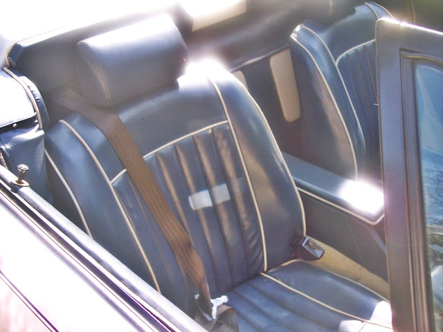

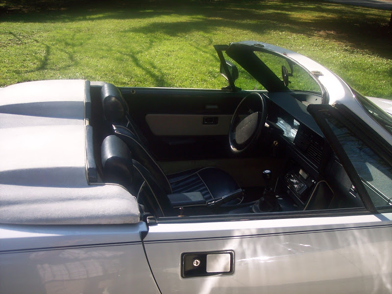

Hi Dave,
A while back my son bought an orange TR7 with a black dash and black and red plaid seats and panels. Deciding that this was less then attractive to me, I decided to change the body color pearl white with a blue soft top, dash, interior seats, and panels. I went down to a local auto paint supplier who a batch of mixed matching blue interior paint and provided a solvent to cleaned the vinyl panels an dash prior to spraying dash, arm rests and a number of other interior plastic and vinyl components to match the reupholstered seats and door panels. To date the upholstery paint has lasted for the past 10 years of use with only a little ware appearing on the driver's arm rest that required touch-up.
My recommendation would be to go down to t he local auto paint supplier and ask their advice if you need a color match. However, I would expect the local parts store would probably cary a spray can of black Duplicolor vinyl spray for an expensive price.
Good luck,
Ray (64BJ8P1)
I have found this paint to provide a sufficiently deep color to make the dash and other components look as though manufactured in that color. However, if you don't need a color match to be performed by the paint supplier, I believe I saw an inexpensive spray can of black bynal paint by Duplicoror at the local your choice of black should be easier to cover the dark blue and I saw a spray can of black Dduplicolor vinyl color spray at th local parts story that
