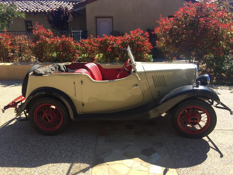

I just brought this home. 80 years old and a little worn. It does not run (ran when parked 6-8 years ago), and needs a little TLC. If anyone has one of these, I am going to need some pictures of your car to help with the fixing. There are a few items missing, but most of it is there.

I have spent a day going over the car. It is a Series 1 4 seater. But I don't have any of the rear seat parts. Also, the engine has been replaced with a later engine from about 1951. Looks the same but has a water pump and a few other items. Amazing that Morris used the same engine for 15 years. The color is not original, they never made yellow cars then, but it does look good with a red interior. Parts are harder to find than our cars from the 50s and 60s. If I decide to really work on it, it needs a new interior, and soft top. Can't just order those from what I found so far. Today, I am going to see if the engine will start.

We got the car hot wired today and the engine runs! the wiring is a mess. Someone did not know how to wire a car. The fuel filter was in backwards and the pump was wired wrong. I turned it over with the crank a few dozen times with WD40 in the cylinders. Put in some starter fluid and it fired right up. Runs pretty good to. Can't drive it yet. No brakes. But one step at a time.

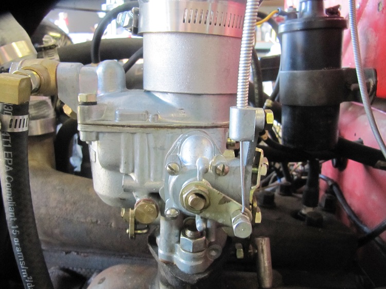

A little update on the car. We have determine what is not original and decided that we can make the visual look original but the running gear is going to stay as it is. Most of us would never know that the engine is not original. It looks the same but has the addition of a water pump and a more modern carburetor. Anyone recognise this carb? I would like to look up how to tune it.
