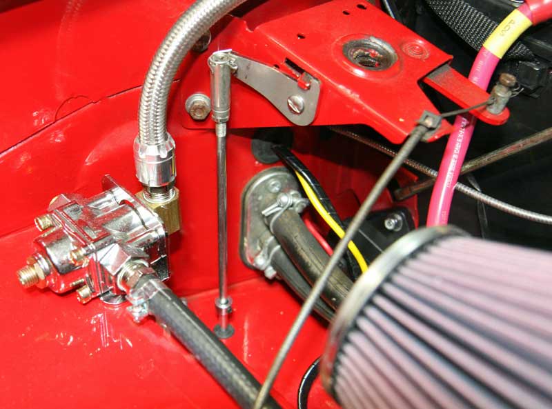

Thanks, I probably should add one anyway, it's just slipped down the list with a new cable installed! Where's the most common location to put one?

Darrell_Walker
Here is my favorite type.

Geo Hahn
Here's mine, just a very shortened version of the generic release cable sold by Moss and perhaps also available in the 'Help' section of the FLAPS:
