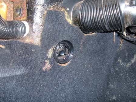

Since winter is moving into PA, I thought it would be a nice touch to get heat into my TVR. Looking at the footwells in either side, there are no vents?? The passenger side gets warm as the blower motor and assembly are on that side. The drivers side has nothing. The previous owner put in new carpets and I'm hopeing he just covered them. But before I rip it up, any pix/comments/suggestions would be helpful.

Here is a shot of the vent in my passenger footwell. Drivers side has on also.

Well, that was worth a 1000 words and explains my lack of heat. I did have 2 warm spots on the rugs in that general area. I guess the PO found it easier to just stick some carpet over the vents!! But in his defense, I think I did that same thing while wallpapering the bathroon several years ago. Humm, maybe we do still have a dog!!!!!!!!
Thanks Ed & Merry Christmas.
