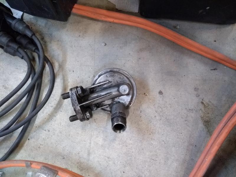

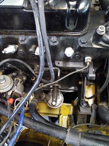

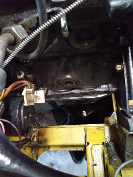

This a late 74 with a 1275 engine, I have owned the car for 30 years. Never had to do this with a new engine, so it is a learning experience.
Rut
Yep, that’s your oil filter adapter with the hoses that go from the block to the oil cooler, then back to the oil filter adapter. The opening that you want to pour oil into is where the oil hose from the block to the cooler attaches to the block. Pull that fitting and prime the oil pump, reattach and turn the motor over with the starter and plugs out. Make sure the hoses have good connections and the proper oil filter is installed. It may take a minute for oil pressure to start showing, so crank it several times giving the starter and battery a rest.
Good luck, Rut
dklawson
The red herring that threw me was your statement that there was no external oil pipe. You didn't mention the oil cooler hoses!
As Rut said, pour oil in the spot where the hose connects to the block. However, instead of turning the engine "forward", you want to turn it backwards so the oil is drawn backwards into the pump. More info on the process is in the link below.
