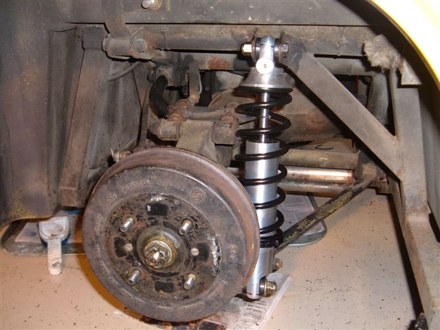

Im located in the US and having a hard time finding new coil over shocks to fit he car. It rides terrible , I want to replace all 6. What kind should I get and from where ? Thank you all in advance joe
TRclassic3
Joe
I replaced the stock with Aldan Eagle. Both ride height and rebound are adjustable and the quality is super. The ride is a lot stiffer than before, so I feel the bumps a bit more, but they sure improved performance in the twisties.

I used Carreras with 150# springs, the were adjusted up quit a bit so 200# probably would
have been better. I only used 2 on the rear.
