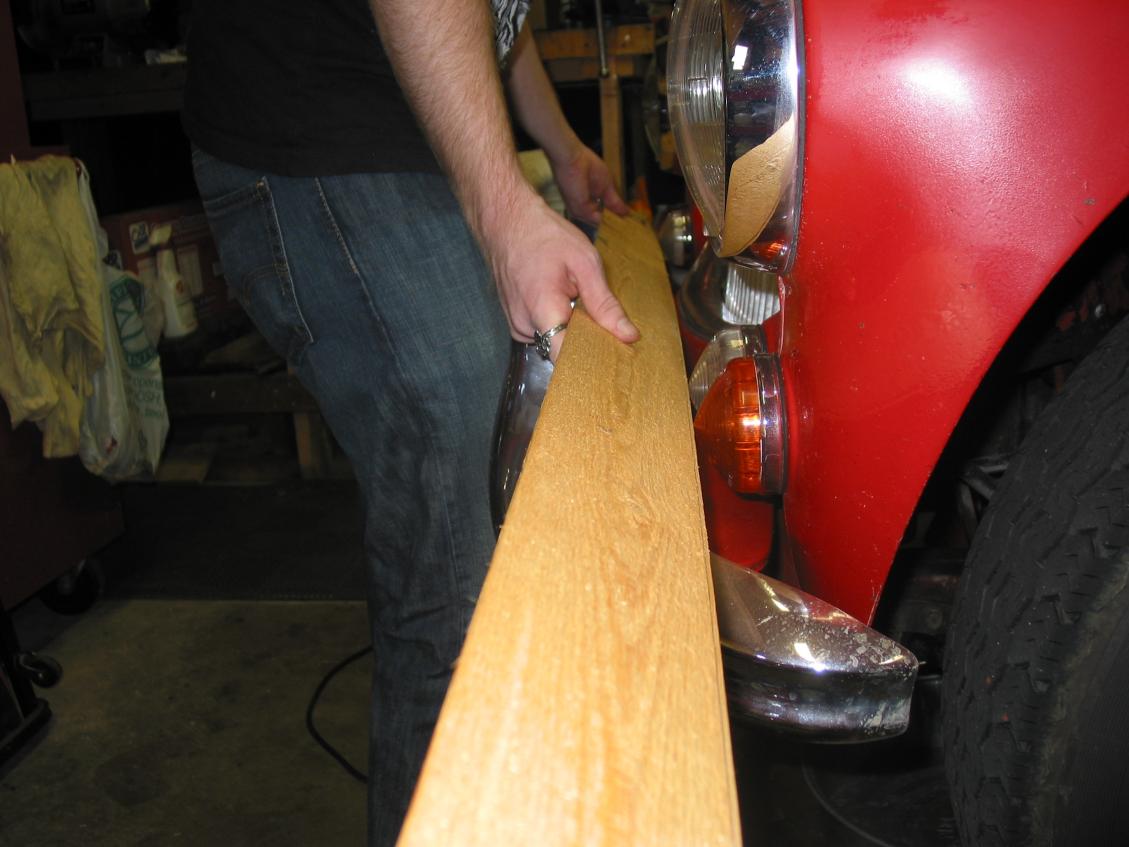

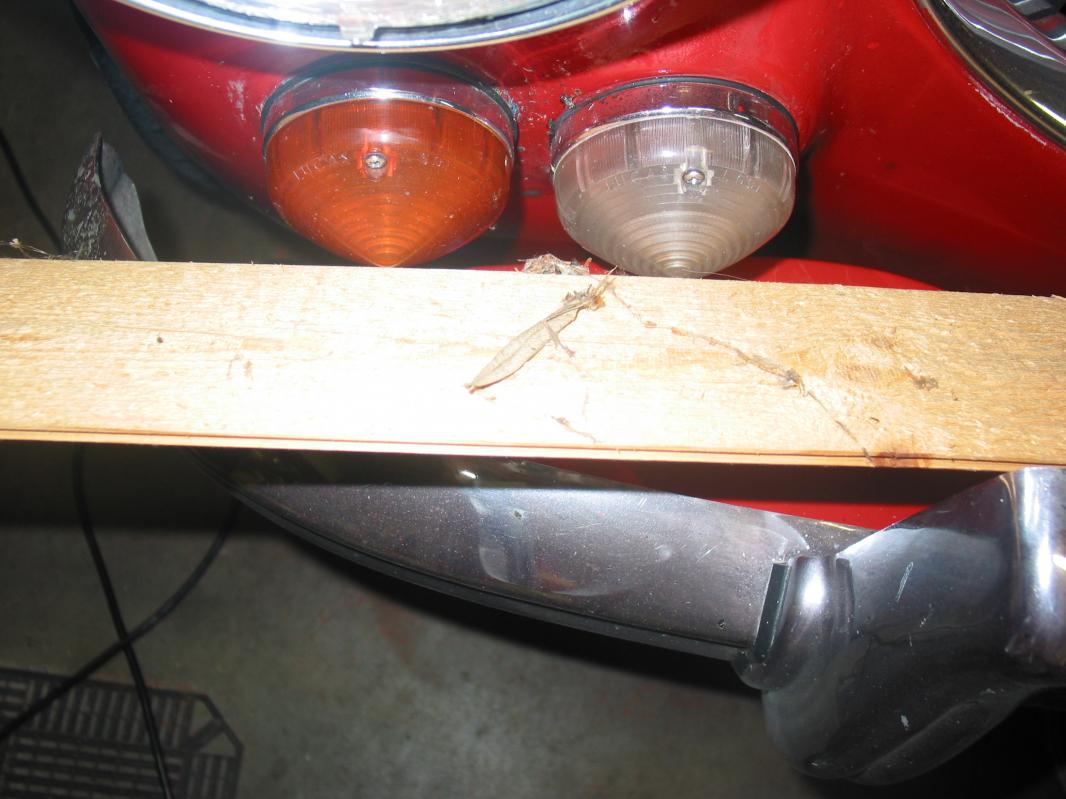

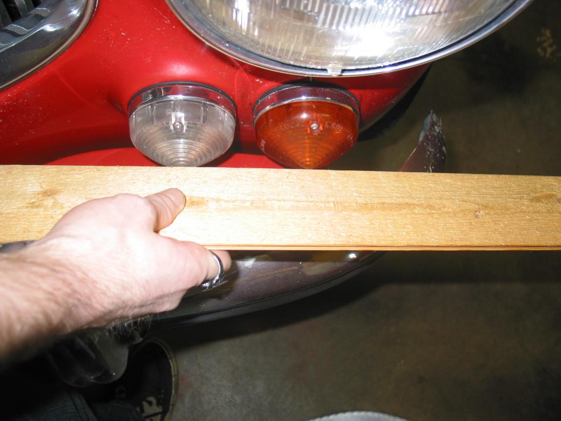

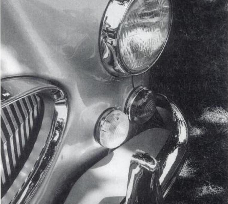

The lights on my car are straight now. (as in Anderson/Moment page 163)
They were a little inwards. The white lights are a little more upfront
Seemed to depend on the way the washers were placed
Another influence was the clamp that holds the wires
Board is fairly straight. I'd say the white lights are slightly 'behind' the orange (1/16" at most), or even.IMG_0025.jpgIMG_0023.jpgIMG_0024.jpg
I think, for all intents and purposes, the four lights should be in a line. Any variation is probably incidental, and possibly due to sag, etc. on my chassis and shroud.
