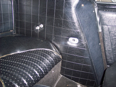

What color and does your panels have two studs for the shoulder harness seat belts or round holes for rear seat belts?

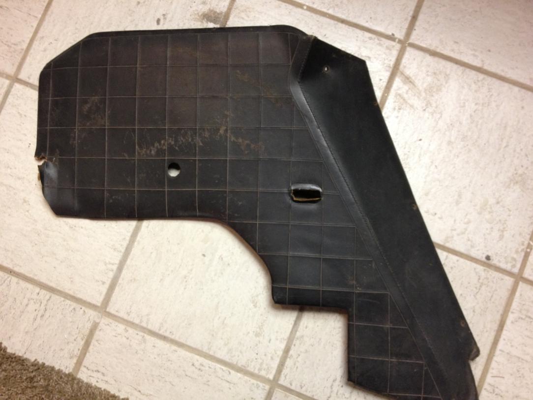

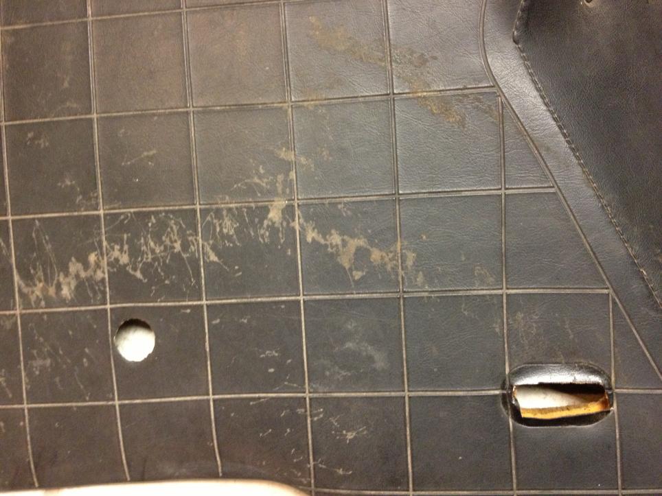

My panels have two studs that go through the panels midway back and they are black. (Vette) the problem which precludes a regular uphostery shop doing them is that the panels have heat embosed squares on them so that isnt an option as I want to keep the original apperance. The panel i took the image of isnt the panel that came out of my car hence the one big hole instead of the two holes for the seatbelt studs'

I believe late BJ8's are the only cars to have the "large" hole for the rear seatbelts(at least mine does) so I think you are going to have more success looking for good "used" condition panels that will match the patina of the rest of your upholstery. I'm changing the color of my black late BJ8 to another color(originally red), and have a whole complete interior in black so I know there still are good original panels, etc. out there.

What condition is just the waffle section of the panel? From the image provided, you may be able to clean up the waffle section and use it as the seat belt attachment and shelf slide receiver are surrounded with chrome and the bolt through the wheel well is covered by the back frame.
A while back, my original quarter panel plywood was coming apart and the front section near the floor was really tattered and brittle. I recreated the wood and metal panels (as I think you did) and reupholstered by cutting the waffled vinyl and sowing it to new black vinyl I found that exactly matched the grain of the original.
One caution, however, when installed, the rich black of the new vinyl made the original door panels black look shallow as a result of its exposure to light and age. As a result, I was forced tocontinue and created new a new interior. The only parts that stayed original are the seats (front and back), cubby cover, and waffle section of the fold down shelf (along with the waffle of the quarters).
Since you have already recreated the supporting panels, I would take the chance of doing as I had. You can always buy new if it turns out to be less then satisfactory. If it looks good, you will have saved quite a bit.
