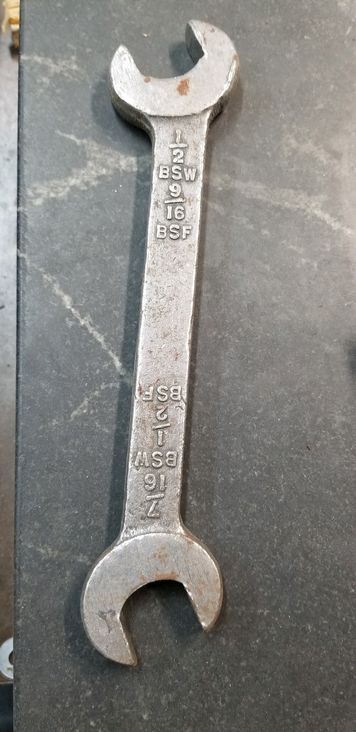

Does look like the cabs use some BSF spanner/wrenches.
BSF and BSW head sizes were brought into line some years ago so there are two sizes marked on them. For instance 7/16 BSF 1/2 BSW At one time you had to have 2 separate sets of spanners one BSF and one BSW.

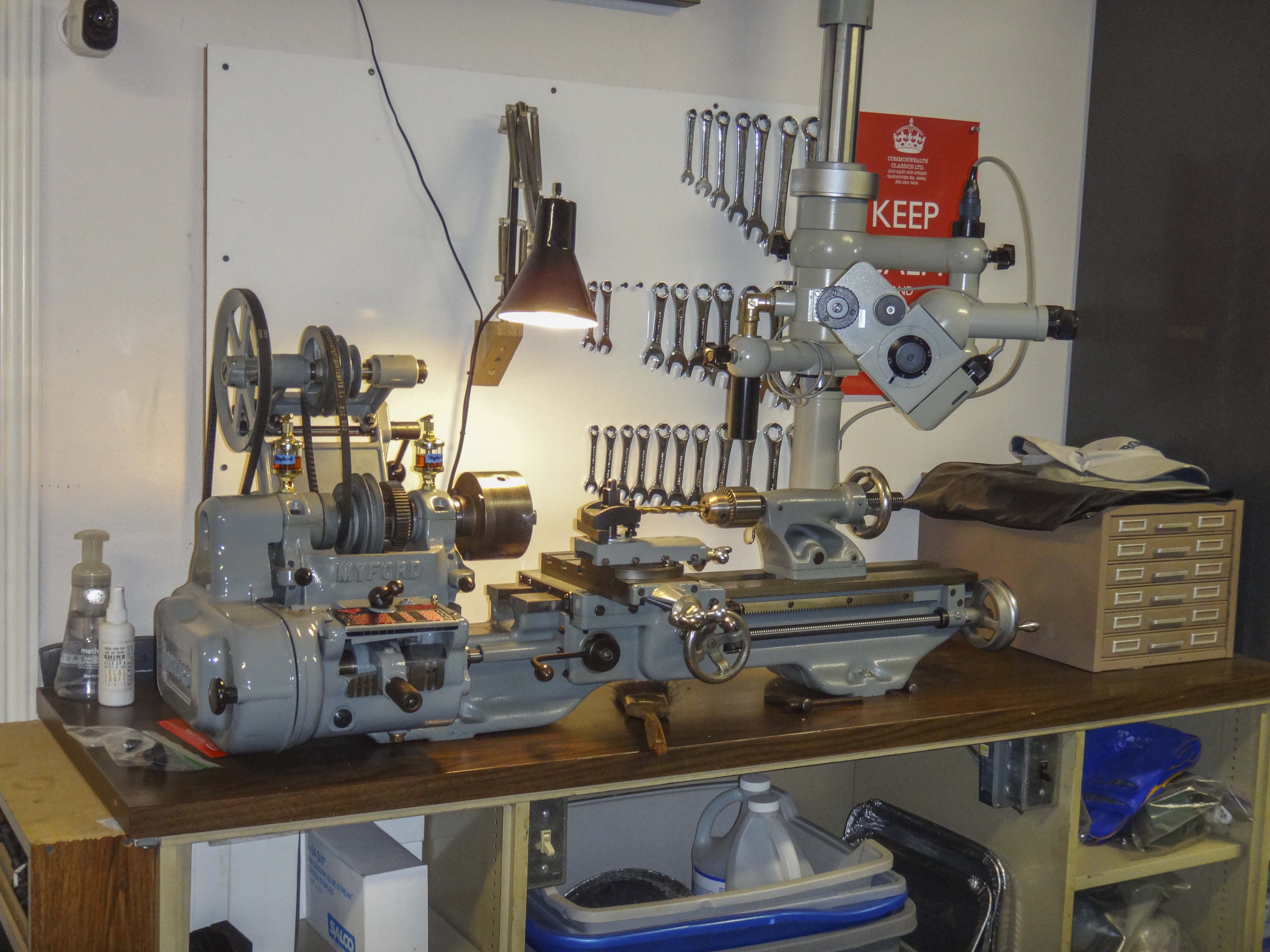

Years ago I bought a Myford lathe from back in the 40s. It's pretty much Whitworth so in one of my trips to the UK I bought a couple of sets of Whitworth wrenches and sockets at boot sales. They were very inexpensive, even though good quality names. In the work I've done so far on our bug eye I've had to use Whitworth wrenches a couple of times but probably could have gotten away with an adjustable spanner. You can see that I have a set of Whitworth, SAE and Metric wrenches on the wall behind the lathe...
The contraption to the right side of this shot is a Zeiss operating room microscope I adapted for doing fine work on the lathe.
