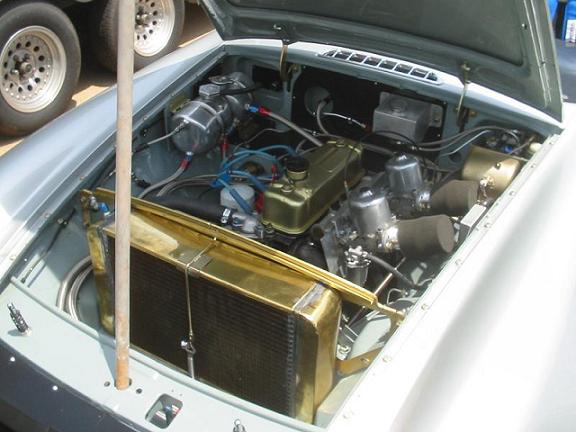

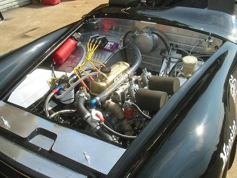

Most people running bell-shaped velocity stacks use foam filters. GO to motorcylce shop and look for the brand name Uni Filter, lok at the catolag and you should be able to find waht you are looking for. Here's the Huffaker MGB with it's sock foam filters over velocity stacks on it's huger 2" SU carbs. The secon picture is of "Speedracer" a SCCA limited prep 1275 SCCA racer, it has HS2 carbs.

I've been using UniFilter units on Webers and SU's for years. Only caution is: as they age the foam can deteriorate. If you keep an eye on 'em and replace 'em when they show first signs of "crumble" they're great. Wash easily with soap 'n water, too.
