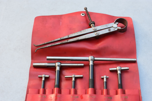

And if you have a "jones" for expanding the tool collection, a set of pin gauges would allow you to measure the choke I.D. Otherwise a set of "I.D. dividers" would come close enough if you take your time and do it carefully:
Pardon the rust on the dividers, I'm the third generation owner. 😉

Hi Dr.
I’ve got all those tools, but unfortunately at my other house.
I’ll continue working this, and will certainly figure out where the accelerator pump jets are, and how to access them.

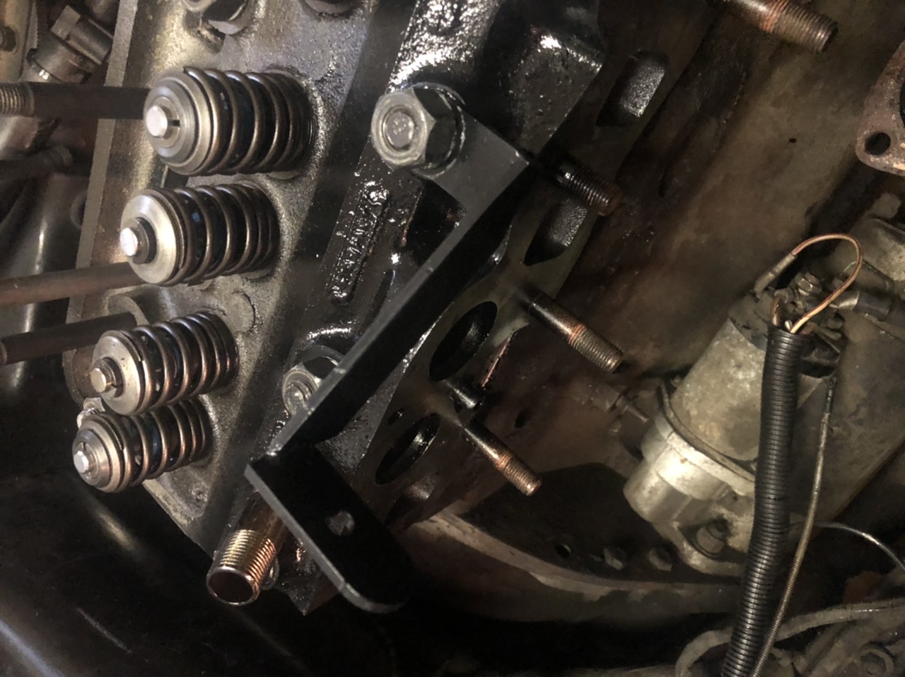

Rocky_LC

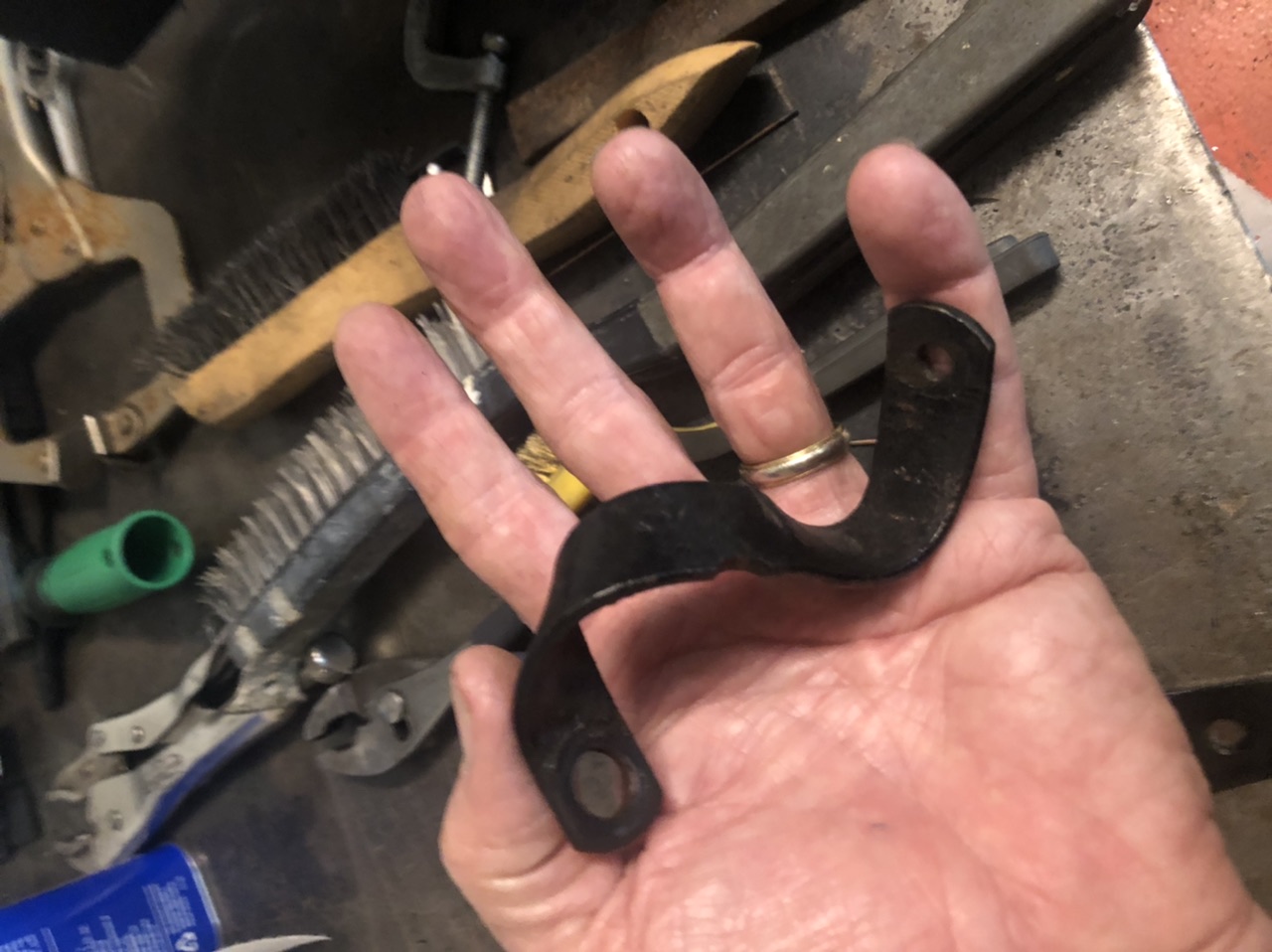

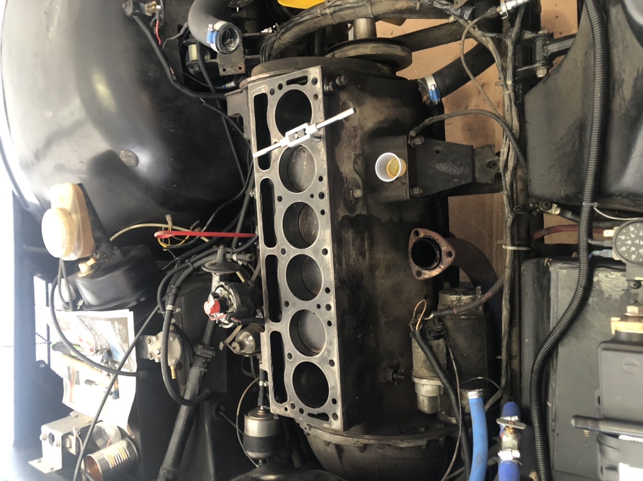

We are working our way forward, and circumstances are driving me towards the rebuild….
Head has been reworked, and installed.
Note new Throttle cable bracket, And the “custom bracket” that it replaced!
The rocker assembly goes on tonight, And the manifolds may get bolted up tomorrow.
Weber anti-vibration seals have been procured, and the rebuild should start soon (maybe one done before our trip to LeMans Classic?).
I haven’t forgot about you guys. I’m glad you’re thinking of me!
Rocky
Platinum
Wow, Rocky! That's quite a bit more in-depth than a carb rebuild! Looks like good progress though. Rocker assembly & manifolds on by now?
I just went through a similar deal with our MGB. Head off, reseated valves, replaced springs and seals. Had a devil of a time finding a ~good~ head gasket. Seems every maker has gone to some flimsy composite thing. First of those failed instantly.
That "reverse S-curve" cable stay is a "work of art"!! In other words, hang it on the garage wall. 😉
I'd be half ashamed to show what we did on a home-made Weber manifold for the MG to get the throttle cable rigged. :rolleyes: Mr. R. Goldberg would be proud.

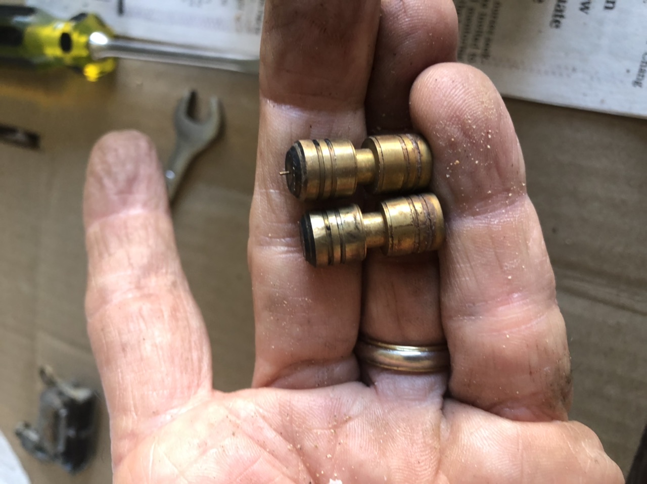

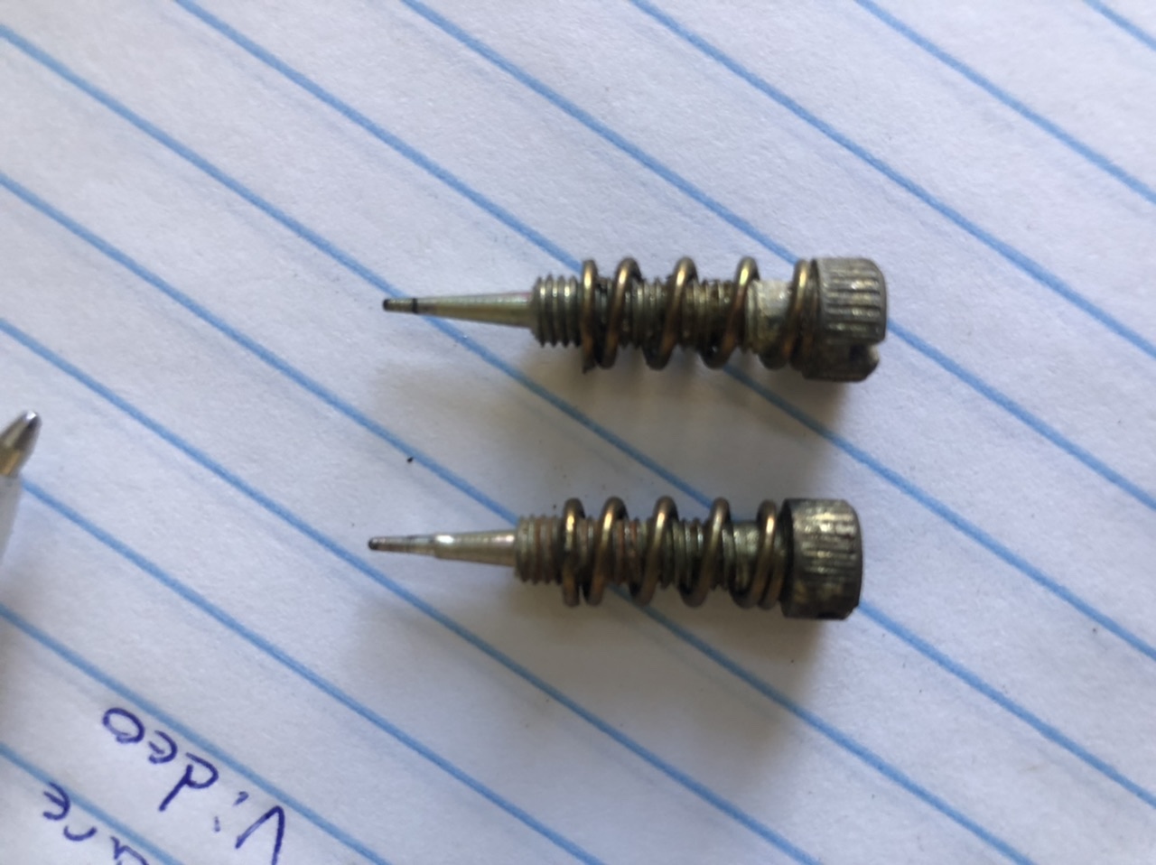

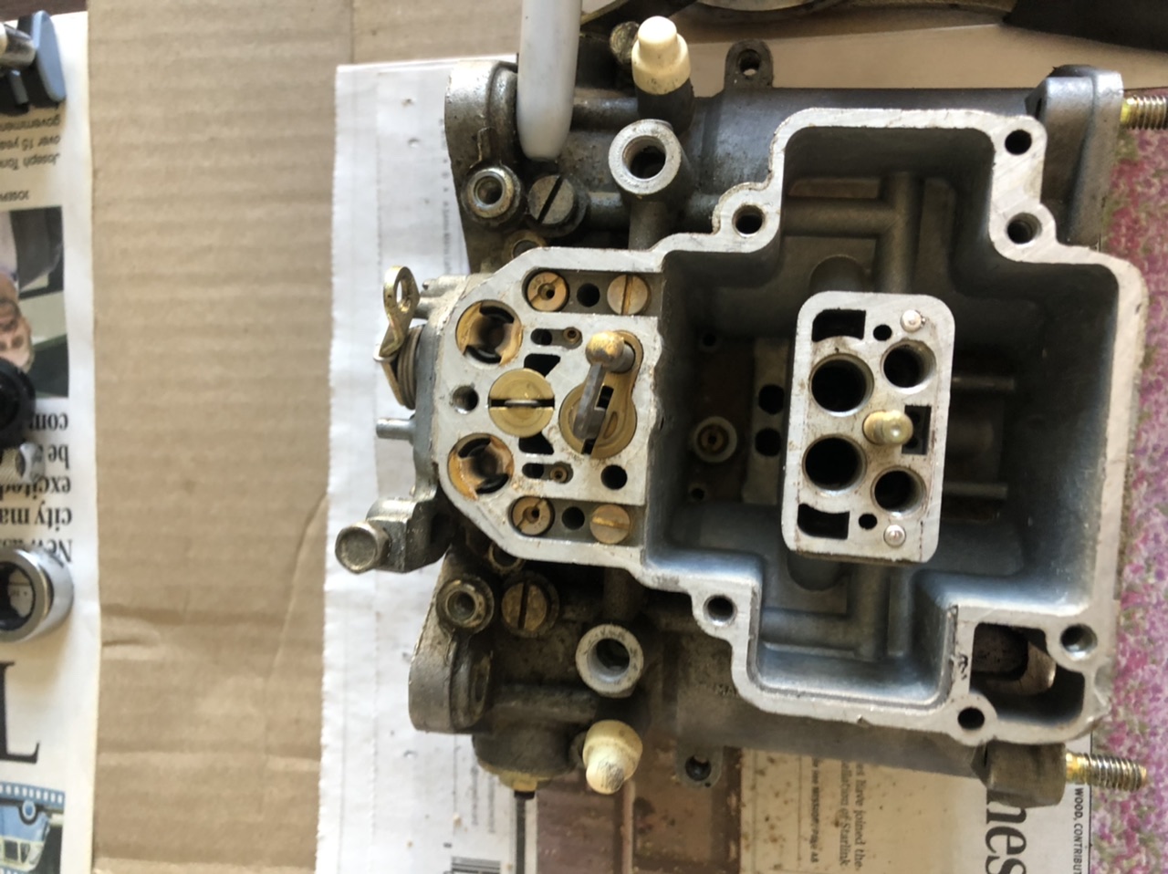

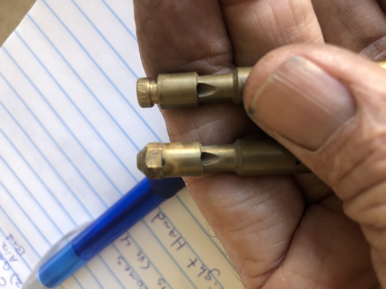

OK, got some questions on my efforts already.
1) Are these the air bypass screws? They look different than in the video that I’m watching.
2) Is my idle adjustment screw on the left messed up? It looks like the taper has been jammed in, and it was a turn and a half further and then the other one was.
3) why would my main jets look different at the end? These jets only seem to come apart in three pieces, the video I watched the guy got four pieces out of them.
Thanks for your help! Remember you guys started this!
Rocky
