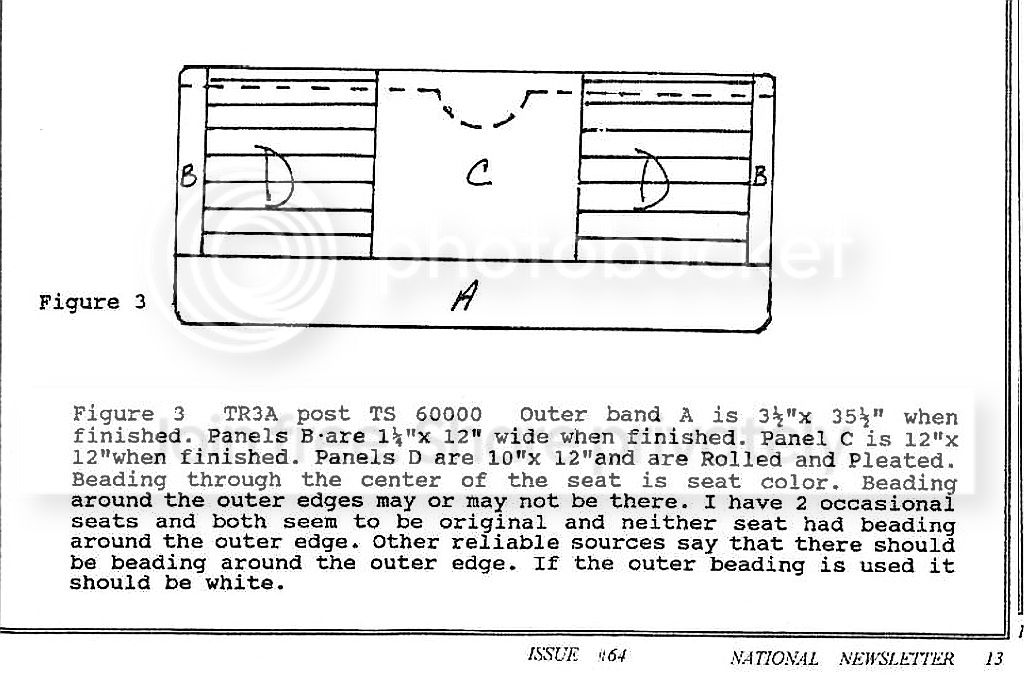

Just got my build certificate from British Heritage today. Couple of surprises. One is the occasional seat. Just saw a pic of one that said it was suitable for early TR3A before TS60000. I'm TS677---. What should my seat look like? Other surprises were the wire wheels. Mine have steel and also the leather interior. I bought the car from the original owner and hopefully he is still around to verify the wire wheels. That's going to heart the budget!
For the later cars, the "occasional seat" was just the bottom. Here's a drawing
Post-60Krearseatcover.jpg~original
The earlier cars (which may be what you saw) had more rounded corner on the seat bottle and an upholstered seat back. If the later ones are constructed like the early one, then about all there is to the insides is a piece of plywood, a couple of T-nuts and some foam padding -- IOW, the only bit you might need to source is the upholstery itself. There will also be some brackets -- on the early ones these were just formed from bar-stock.
I don't believe the brackets were needed with the post-60K version. The body has a flat shelf already, and the seat bottom sits on that.
IIRC, the TR3 had a separate upholstered back for the occasional seat, but the 3A had the upholstery built into the standard panel and no separate piece, giving just a smidgeon more room. The brackets were different too, as they had to support the separate seat back.

Rear seats are identified thus -
TR2 - no factory rear seat offered, although there was a prototype that didn't reach production. Homemade/aftermarket versions were seen that utilized the space behind the seats.
TR3 - Optional rear seat comprising a cushion and padded back fixed to a bracket either side. Brackets bolted to the floor and adjacent sloping panel. Leading edge of the cushion was curved. Passenger seat now tilted forward for access.
TR3A - Pre 60K. Optional rear seat was just a cushion. Re-designed brackets as padded back now deleted. The leading edge of the cushion remained curved.
TR3A - Post 60K. As per Randall's image, now a rectangular shaped cushion that sat on a new squared off rear shelf.
