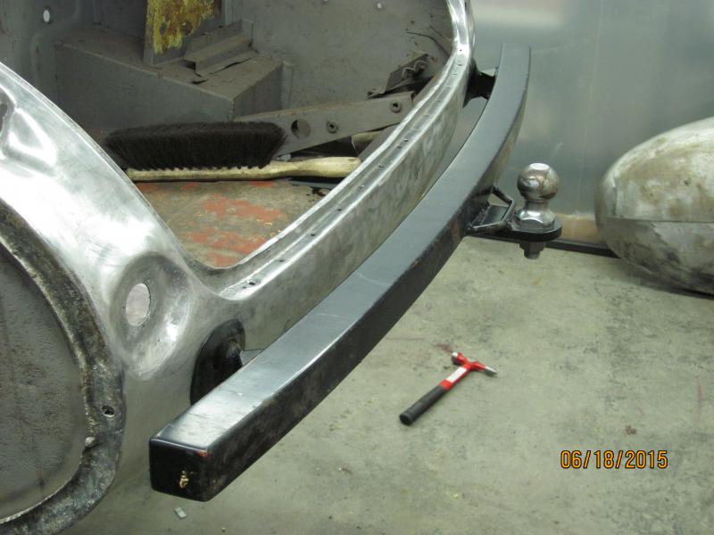

Randy i I love your idea of attaching to the ends of the rear crossmember. I already have a bike rack that lives on the back of my daily driver (saab convertible) but would love to toss on the healey someday as well. I ordered a class 1 mount hitch from Amazon for $26 and will try to weld up an adapter to go to the crossmember. At that price I'm willing to gamble that I can weld on a reinforcement plate with captive nuts.

So I ordered a hitch from Amazon for $29 (with free shipping) and it arrived last night. After I ordered the price suddenly jumped to $170 ( https://amzn.com/B003PJ0IBY ). I plan to mock it up this evening and figure out a game plan. It doesn't look like it will be hard at all and I will happily post pictures of my solution.

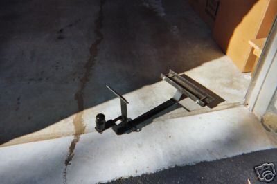

Lotuswins
attachment.php

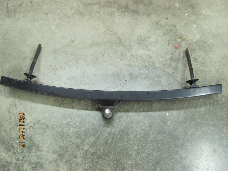

Thanks Jerry. That's an interesting design. Any idea what this part is?
attachment.php

I believe that part bolts to the bumper, either on top where the license plate light does, or drilled from underneath, but into the same holes. You can sub a receiver for the ball portion, I would put the small one on, and it should hold a bike okay. To stabilized the bike though, you might think of bungy cords or straps to the bumper guards to keep the bike from twisting. Also, since it bolts through the rectangular rear portion of the frame, welding tubes in would be best to keep from collapsing the frame. just a few thoughts. I found this picture on the internet somewhere, but have seen the same thing on a healey in Portland.

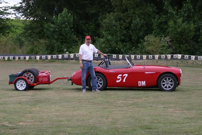

red57
This has been my solution for the last 15 years or so. I've logged around 10k miles towing. Trailer fully loaded is around 4-500#, tongue weight about 30-50# and when I arrive at the track, four bolts and it's off. I normally run my car without bumpers so I had already moved the license plate light to the license plate so no wires to unplug. I used a coule of mangles stock bumper brackets cut off and welded to 2x2x.125 square tube with a piece of 1/2" plate welded on for a ball mount. Not an alternative if you want stock a bumper.

I have not tried to inset photos before so I hope this works.
Dave

red57
Wow, sorry guys, I though there would be thumbnails like I see in other posts. Obviously I don't know what I'm doing:tennis:

Full size photos good Dave. Less clicking. My dad did something similar to tow a 16 foot speed boat. Launched and retrieved the boat down a ramp into the water.
