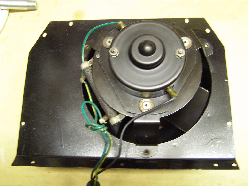

Kevin,
Here is a picture of my motor when it was out. I had no white wires in there at all. Just the two green striped wires and the black.

These fans use single winding motors. To get low speed operation, they reduce the voltage by using a dropping resistor. If you look at Paul's photo, the black cylindrical thing is the resistor. You should have one fused lead (solid green) into the heater fan switch and two wires (green with brown tracer + green with yellow tracer) out to the motor/dropping resistor. Connect as shown below.

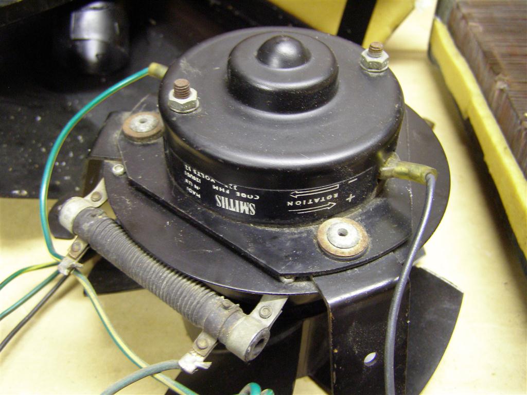

I am using your article, Paul - thanks for posting it. I find that my 69 has a lot in common with a 250 many times. The may be why there is a difference. In any case, I am including a pic to explain myself better. (There is fresh soldering only because I had to shorten and then resolder the wires due to mice damage.)So, I have two white wires coming from the motor. One goes to the resister. The green/yellow wire continues from the white wire at the resister to the switch. On the other side of the resister is a green/purple wire that goes to the switch. The other white wire goes straight from the motor, and it is that wire that I have not idea where it goes. T, looking at your diagram, wouldn't the white wire have to be a ground wire then?

Kevin,
If you look at my picture and forget wire colors for a minute, you will see that you have two wires bridging the resistor, one of which comes from the "motor", which will be positive. Therefore, the other wire that comes from the motor will be ground. You can test this by hooking up the ground to your battery and the other wires to the positive terminal and the motor should turn.
If you will notice on mine, there is a + and a - on the label. Switching those around will affect the rotation of the the fan, as indicated by the arrows on the label. You want to make sure yours is wired to turn in the proper direction after it is mounted so that you push air over the heater core and out of the heater box and not suck it in like a vacuum cleaner.

Kevin,
Along with my previous picture to show you the wiring on mine, you can see how mine mounted to the top of the case.
I believe that it will be rotating clock-wise.
