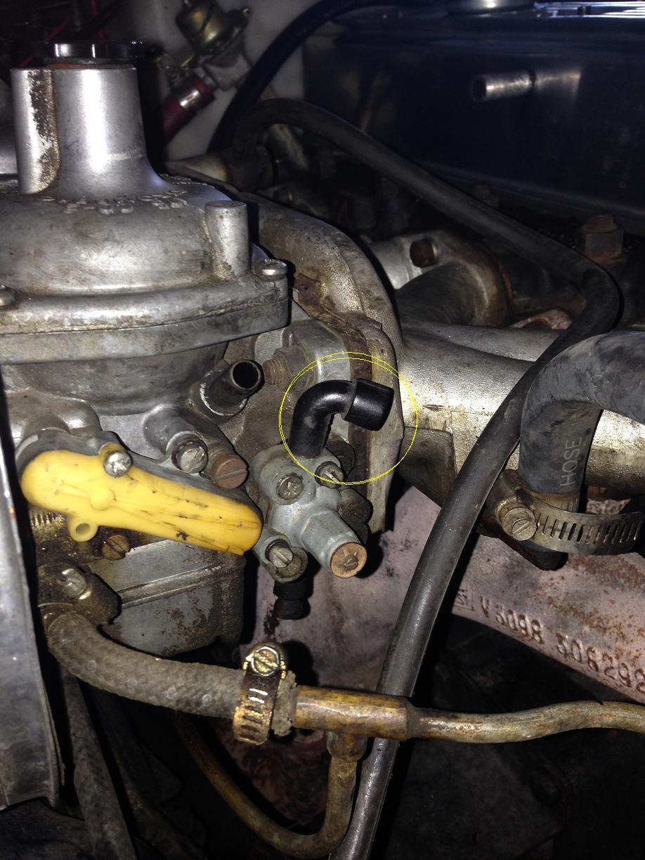

Lately I have been having problems with my TR6 running good. Attached is a picture of some sort of vacuum something, each carb has one. These have always been open. Lately they are hissing when the car is at idle and making it run a little rough. When I cover up the holes the idle smooths out a little bit.
My symptoms have been the car will run real rough for a few seconds and then run normal again. I blurp the throttle and then it runs good again. Sometimes the car will die at idle. Revs help out with this problem.
I have replaced the diaphrams, plugs, wires, coil, rotor, fuel filter and run some injector cleaner through a tank of gas. I have been putting in 91 octane. Any ideas why my car will have these periodic spells of running bad? I plan on attending the Brits in the Ozarks show this weekend so I do have a deadline. My next step of action is to replace the fuel pump.
My car is a 73 but it looks like the carbs are off of a 74. The tags say 3613.

That is a nipple thru which the Throttle Bypass Valve (TBV) of the 74 carbs sensed manifold vacuum.
Obviously you do not have it plumbed like a 74 so if you find capping it is having some effect it's probably because the TBV diaphragm is shot, brittle and leaking or floating..Therefore you should turn the TBV adjustment screw as much counterclockwise as it will go.
In this picture you will see the adjustment screw like your's on the TBV on the right. The TBV on the left also has an adjustment screw but it is concealed under the brass tamper proof cap.

BUT the reason I suggest disabling the TBV is because you have no method of working it properly.It requires the ability to sense manifold vacuum to function.
Where would you connect the 2 sensor nipples ? The 74 made provision for this at the Thermostatic Vacuum Switch manifold... You have that ?
It's similar to this EXCEPT it has 4 nipples not 3.
I see no advantage to replacing a diaphragm..just stop the leak by compressing the valve against the fuel passages in the method I described..
Disabling the TBV is a fairly common practice..either by the method I described ...OR as I and others have done, by making a solid gasket that covers these passages.
In this illustration there is a "Sensing to Manifold" port..but the 74 uses the external nipples to sense manifold vacuum and make the valve work...
If the TBV were not leaking..I don't think you'd even be aware of it and whether it was disabled or working normally.

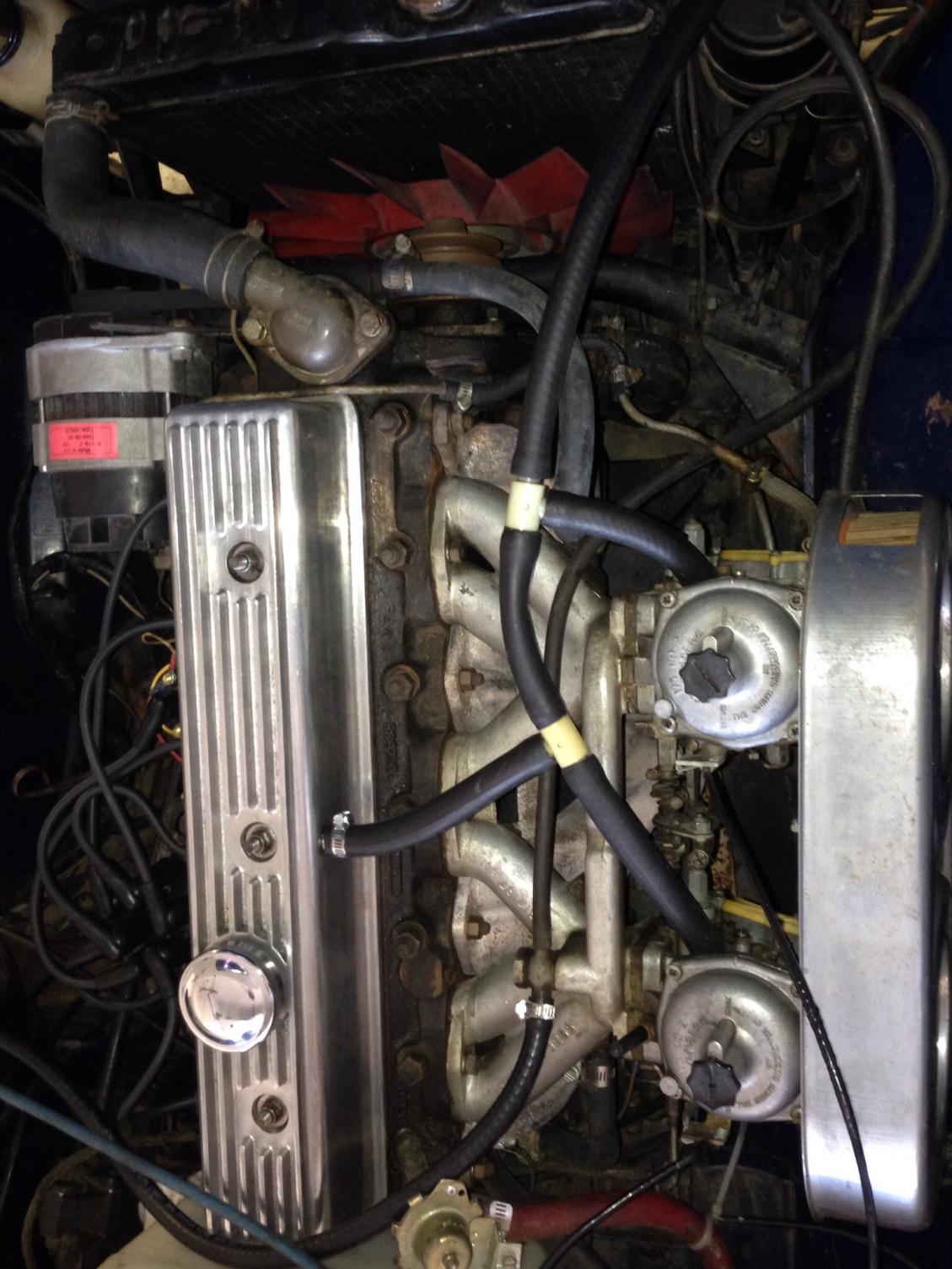

Here is a picture of my current set up
Would my petronix be going bad? I've read where people have had problems with it and switched back to points and condenser.
Update. I plugged the 2 snorkel things in the first post on both carbs and drove to Victoria British(10minutes). After that it ran pretty well. It had a little stumble at one point but never happened again. I took it out on the highway for a few minutes and didn't have a problem. Maybe this is a temporary fix. I guess I'm planning on rebuilding my carbs this winter. I also replaced the fuel pump today. Maybe that will be part of the problem.
