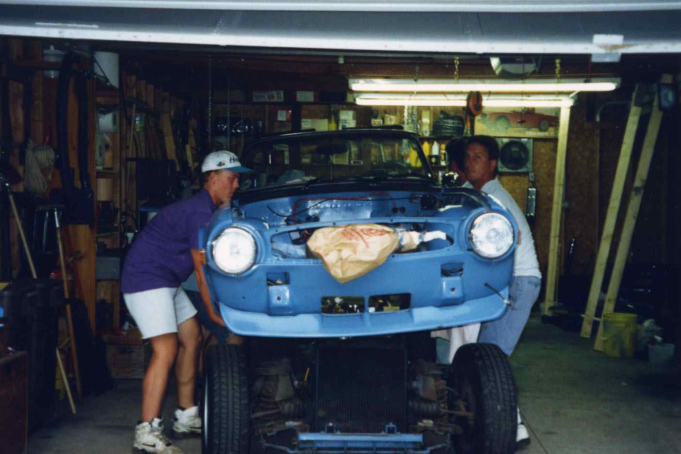

My guess is they physically lifted it to the stands. Jacks could easily damage the body unless there were four or more, and still would be slower and more tedious. With as many guys as they had helping, lifting would be pretty easy.

Six guys lift it off and set it on a wooden jig.
