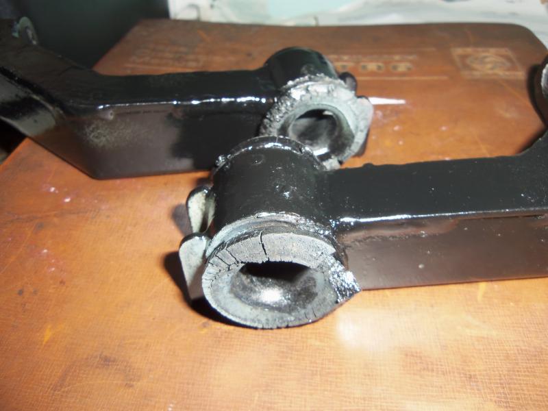

Here is a pic of one of the control arms. They are more deteriorated on the outside but the inside is just starting to deteriorate. Very little life left in them. Looking on line last night and in my catalogs just got confused because there is a bunch out there. From $20 to $250. I want a good pair that I won't have to do again when I'm 75 but also don't want to brake the bank. It wouldn't be fair and I would have to guess where I got this set from some 12 to 15 years ago. But they are straight urethane and with out metal inserts. I like the idea of the inserts insted of running the rubber directly on the fulcrum pin. I'm going tomorrow to my local Triumph supplier and see what these Prothane bushings are all about. If the front are that bad and I never did the rears. (had the car since 1976) then the rears got to be horrible.

I have not seen bushings with metal inserts for the fulcrum pins. Mine were just straight poly that slipped over the pins. The bottom were steel sleeves with nylon inserts.
Thanks for the picture. Food for thought, to say the least.
