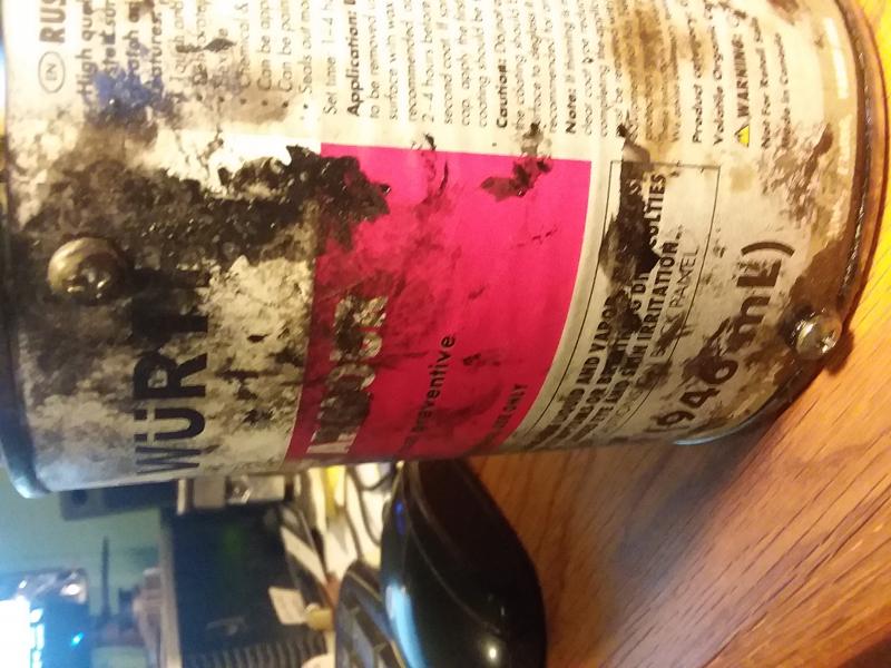

Got_All_4
I sell this stuff for a living. My company has it's own version of it and is almost identical. These types of paints need two things to cure. Moisture and rust. So if your dipping your brush into the can and brush painting something and repeating that cycle then your introducing a curing agent into the paint. If you intend to use the entire can than no problem. Why this product works so well is because it needs moisture to cure. Why is something rusty? Because moisture is in it and has caused rust to accrue which has moisture trapped in the rust scale. The paint pulls the moisture out of the rust so it can't continue and the paint is so hard and has no pores so it is sealed from the outside elements.
Brushing is perfectly fine and you will be pleased with the finish. If you plan to spray it, use urethane reducer to thin it and WEAR A SEALED PAINTERS MASK that filters out all chemicals because it WILL KILL YOU if you get it into the lungs. Remember it draws out moisture and your lungs will become a rock!
What I have told my customers to do is use aluminum foil between the lid and can. You can only do it a few times if your lucky. The best way is how I have pictured and that is use 2 screws. One on top to break the vacuum and the other on the bottom for a drain hole. unscrew the bottom then the top and streem it into a cup. No chance of any contaminaion. Some times if you over tighten the screw you will have to put an "O" ring around the screw head to help it seal. Hope his helps.
