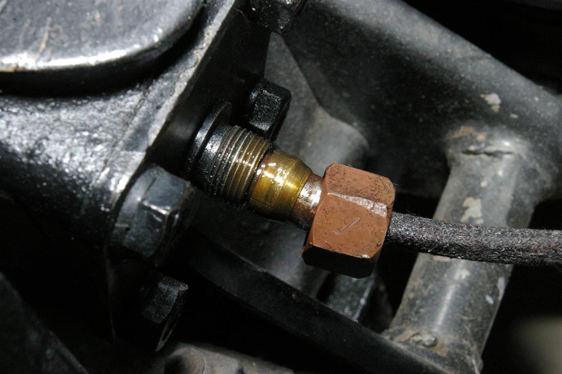

Believe original olive was tapered on one end and flat on the other (as well as split). Think I ordered mine from TRF and was as original. Have read about issues with olives that are tapered on both ends (like regular plumbing ones). I was not sure which way around it went and when I asked before completing installation I found I had it backwards. So this is a picture of how NOT to do it. Should be flat to nut and taper to box. Cheers, Mike
