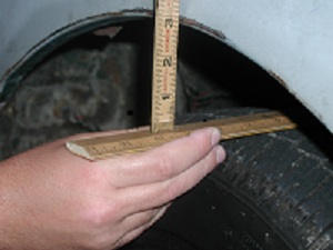

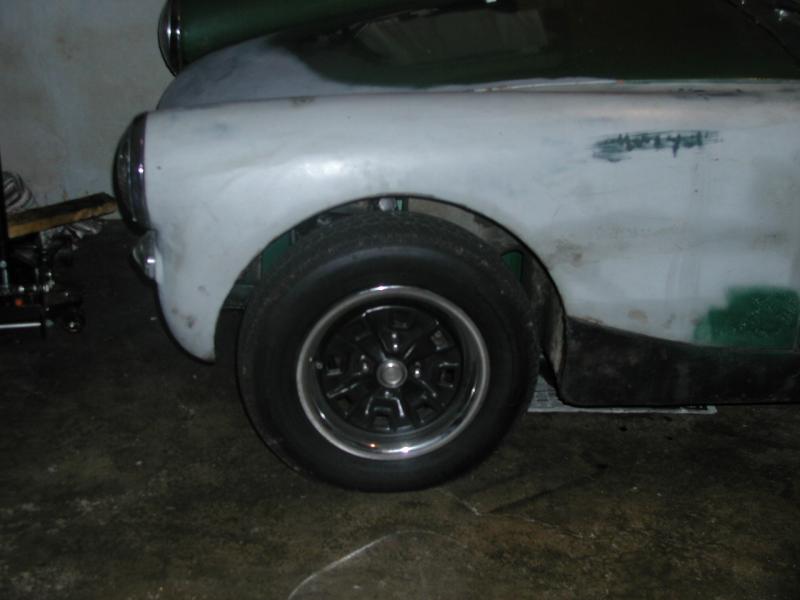

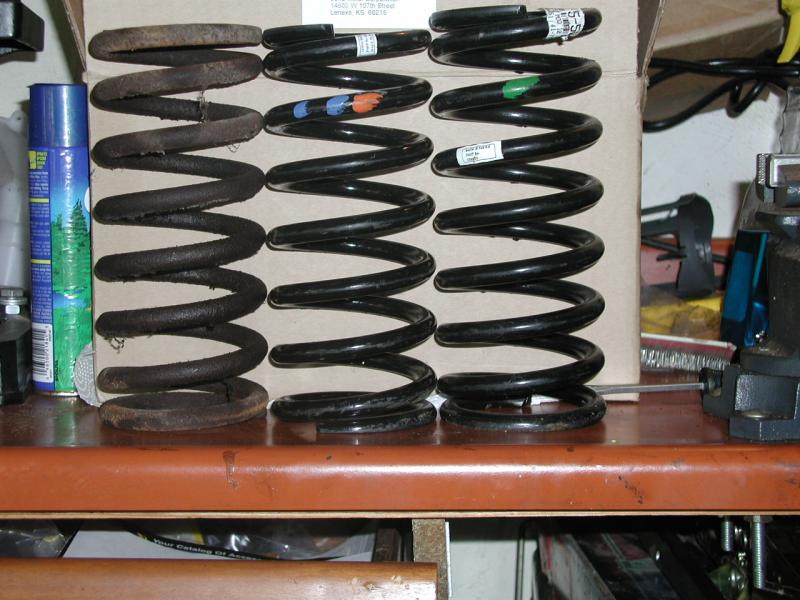

You got shipped the wrong Springs, Likely later Midget Springs for RB Cars. Here is what happened to me after I installed Replacement Springs for BugsyI my '68 Sprite.
Picture 1 - Sprite with Wrong Springs
Picture 2 - Measuring the gap
Picture 3 - L - Original Spring R - Spring Originally Shipped to me, Middle Replacement Springs Moss reshipped to me.
Boink
Bronze
I had the wrong springs on my Sprite (a Bugeye) for a number of years! Like Jim's photo of the springs, the difference seemed subtle but changing to the proper ones made a huge difference.
