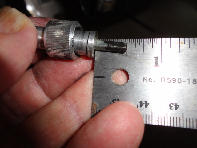

My speedometer doesn't work when I tighten the Toyota speedometer cable to the speedometer housing. I tried my spare speedometer and the same thing. However, when I loosen the cable from the back of the speedometer housing it works! The cable sticks out 1/2" out of the cable housing that attaches to the rear of the speedo housing(see photo). Is this the correct length or does it need to be shortened?

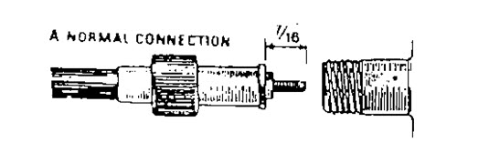

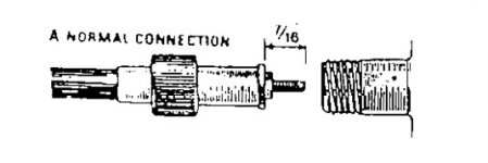

7/16" is correct per this drawing from Nisonger:

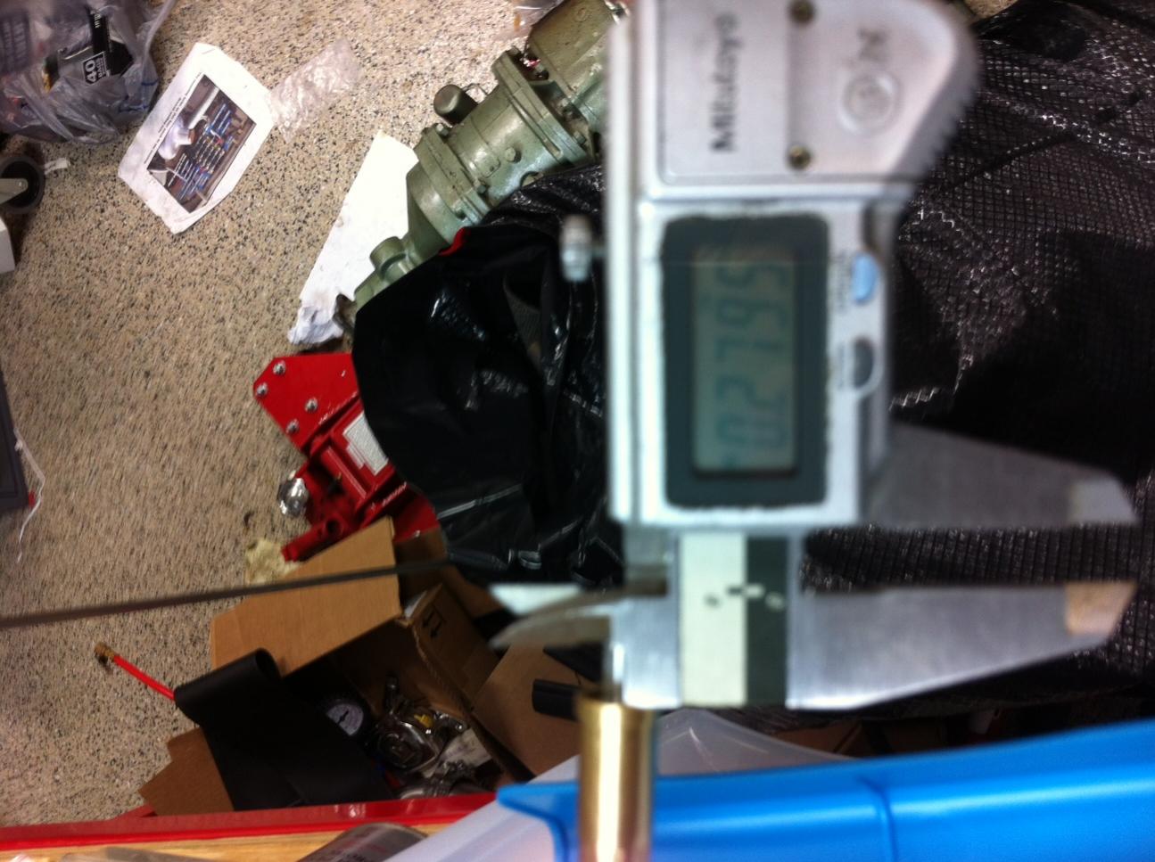

More will damage the speedo. Not sure about the .27"
