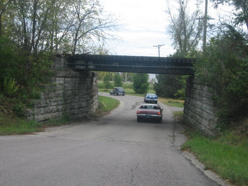

The "Double S" railroad underpasses were the early highway designers' attempts to mitigate the hazards of at-grade rail crossings. Unfortunately, the solution ended up being equally deadly. There was a big push for these underpasses after an accident in 1934 or '35 where a B&O locomotive struck a school bus, killing 16 students.

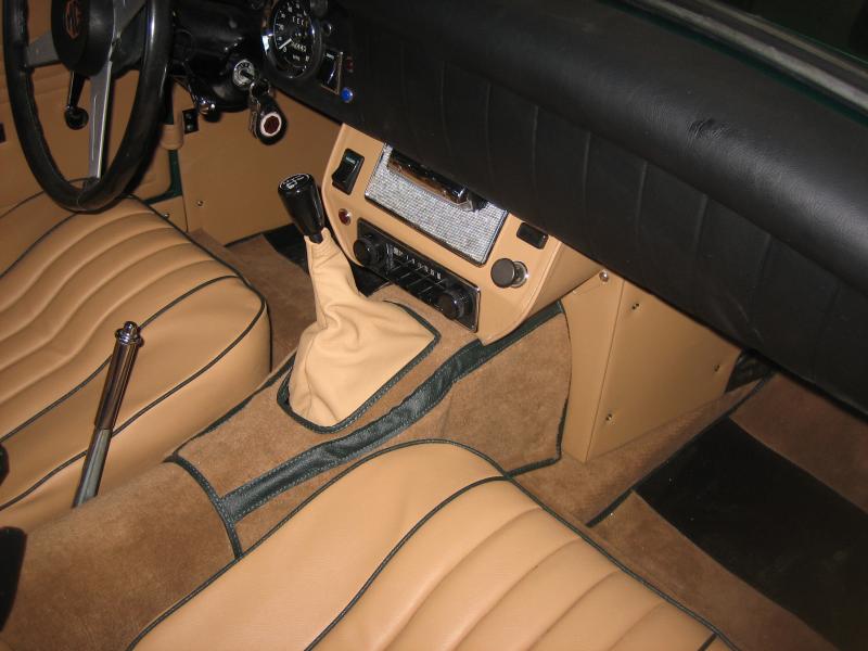

Thanks guys, I think the carb problem is sorted. The oil in the dashpots was just to thick for the cold weather we have been having. cleaned them out and used some much thinner oil and they seem fine. I also backed off the brake-light switch and that seems to be fine. Although I do need to adjust the rear brakes now.

Wow, that interior looks great. Very sharp.
