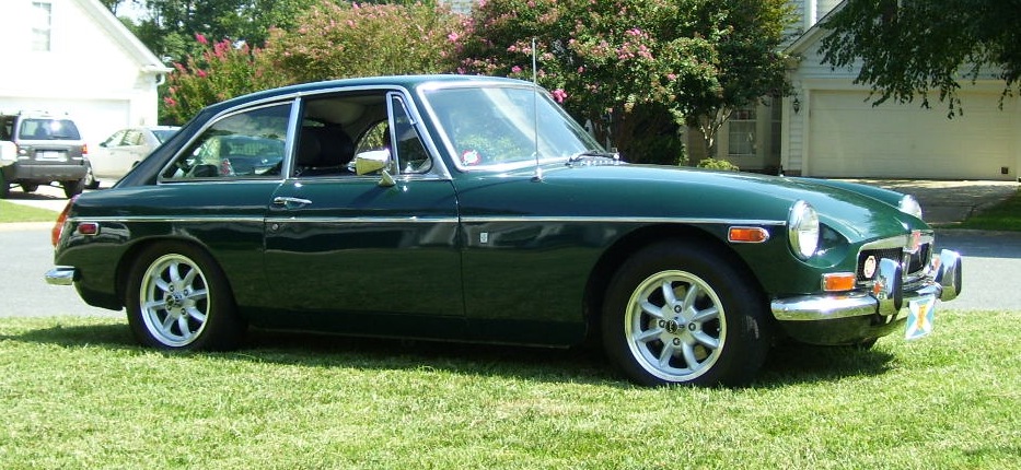

Flash_Harry
This is my '74 GT with VTO wheels from Hap. He also has other types.
Harry

PAUL161
Harry, That is one sharp looking B! PJ

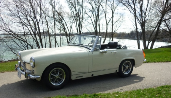

JPSmit
FWIW there is no template for Midgets - I did mine with painters tape - a little more time but I'm pleased with the results.
