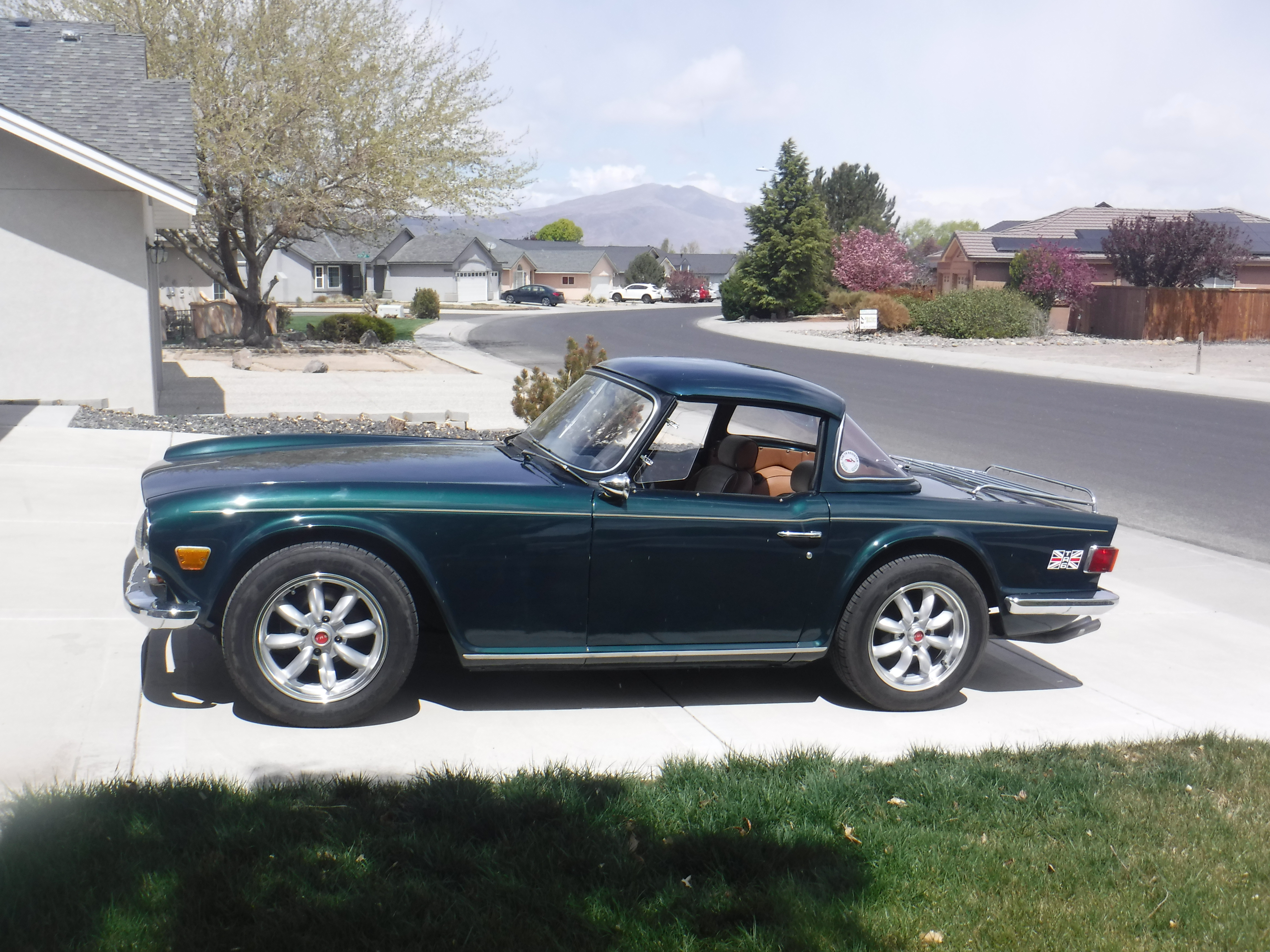

I did my first one in 1993 TR6 1973. as I had to start with a new frame it was defiantly a frame up. The good part is I now know every part of a TR6. The bad part is I know every part of a TR6 and as I started with one driver and two parts cars I had ex stuff for years. I did the complete restoration in one year so that was a plus. I did not drag out for years as many have had to do. To note I worked part time at a LBC shop so had insight into the work and back up also. No regrets and on the road to this day. It was built as a road trip car and has been from the Mexico border to the Canada. It is a almost 30 year old car again.

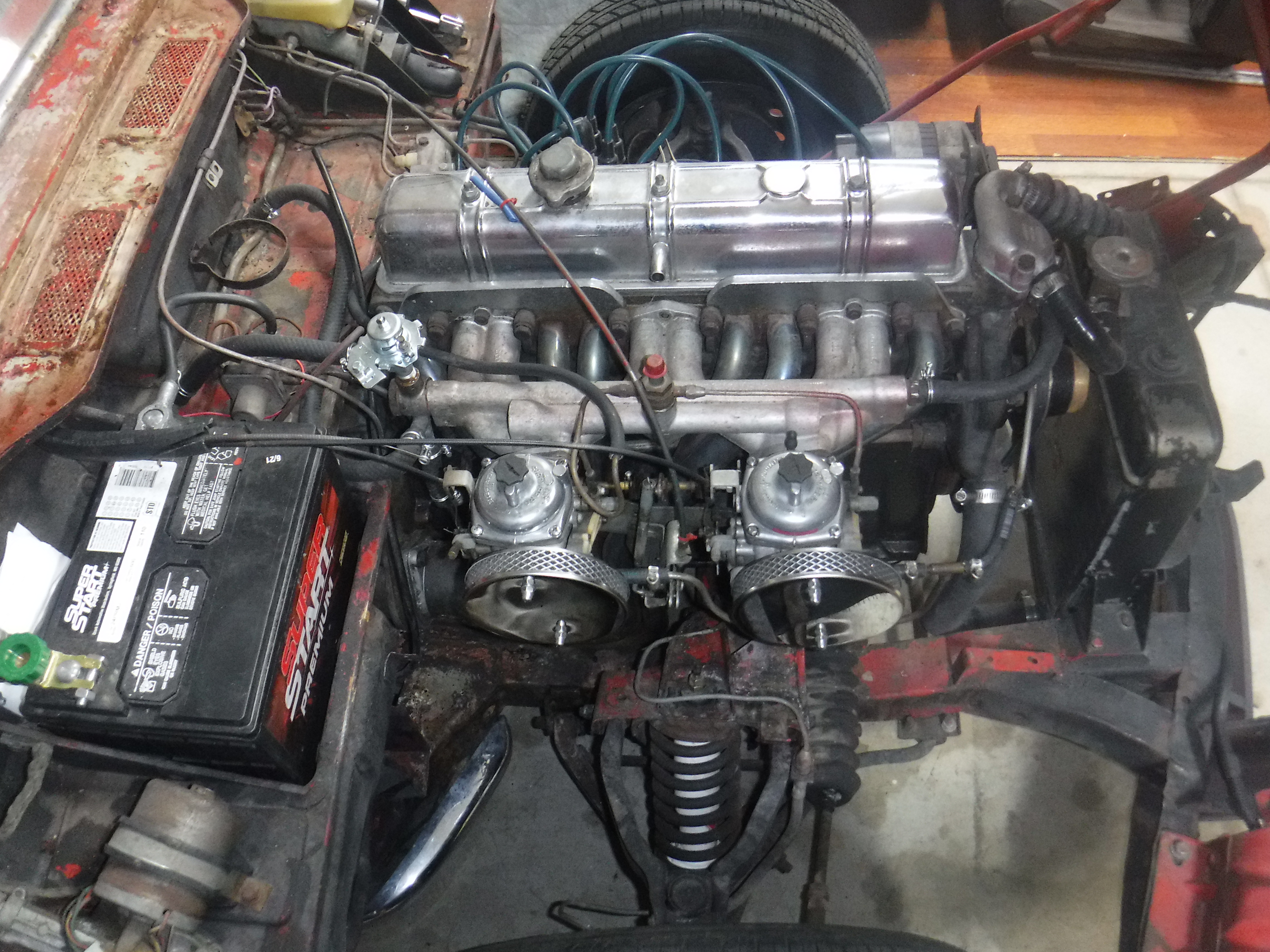

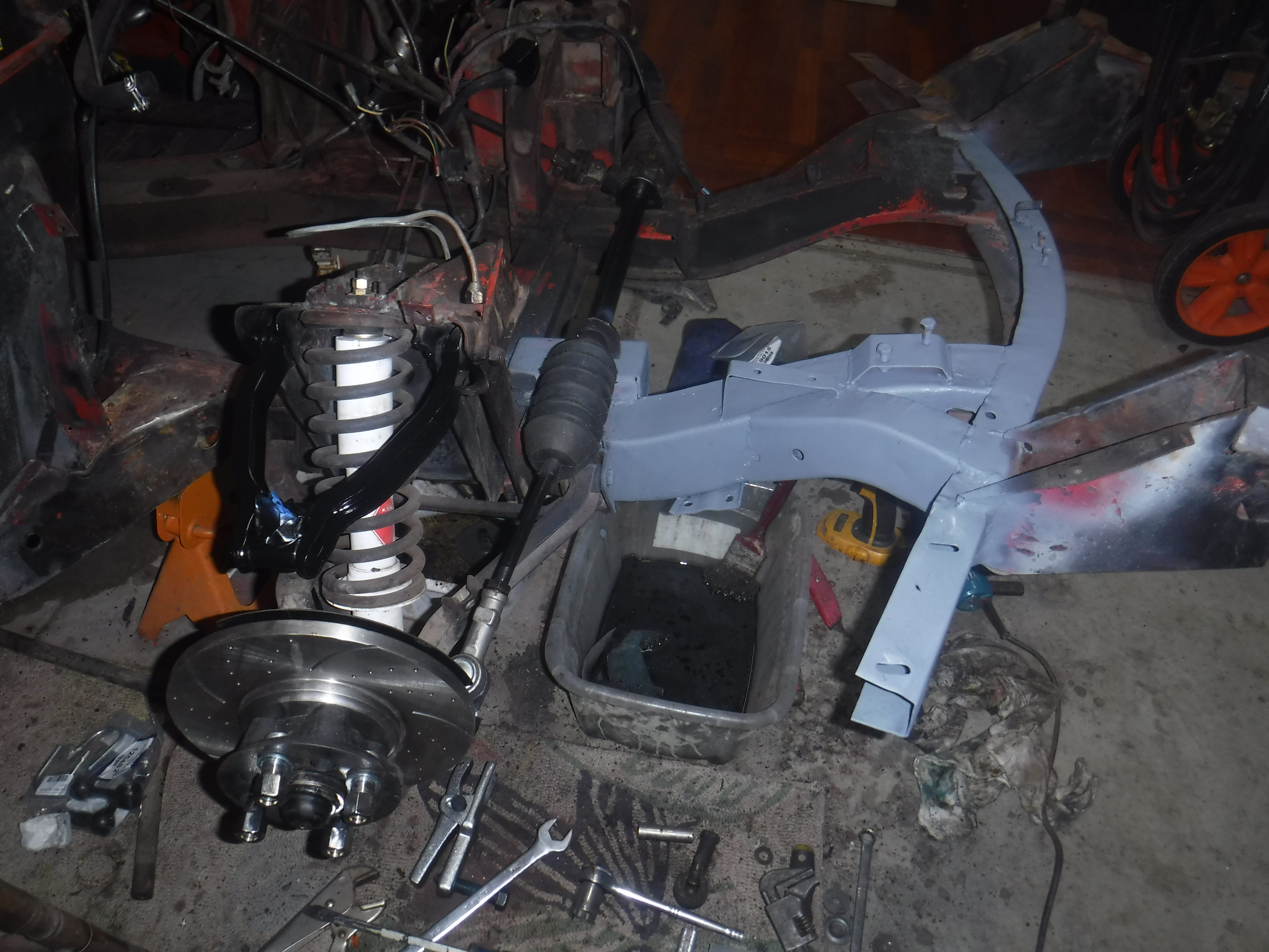

This last July I started a new project , 1972 GT6. it is going a little slower as I know little about GT 6's. As it is said a poor man's E Type, the 6cyl motor is about the only thing similar to the TR6. C19 and being retired gives me much time to learn about this little car. some motor work has been done note headers elec. fan compression is 120 psi all cyl and as I started with one driver and one parts car total cost for all $2,500.00 so cost are good so far. As also been said time or money you choose that is what is called restoration of the mine when retired.
Madflyer

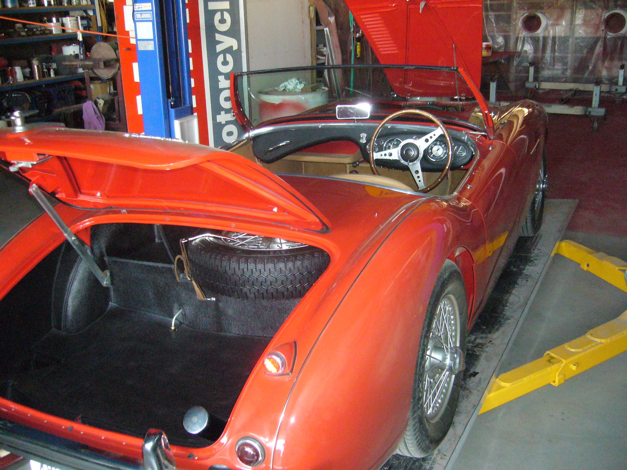

Two things.
I used the old bits of the floor around the gear box cover to pattern two new pieces to make them myself. Just welded them in without trying the gear box cover first, later I found that the gear box cover does not quite fit properly.
I was going to leave the petrol tank out of the boot after I rebuilt the boot floor so that I could see the boot lid locking mechanism and make adjustments accordingly, - - I did not and had a we bit of a problem getting it all right.
You learn by your mistakes
:cheers:
Bob

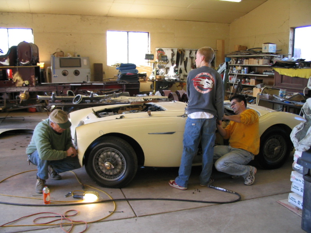

I would have done more research on the restoration shop I chose , and should have pulled my car out of there at the earliest moment I realized that things were going very badly. BTW, the shop is in Philadelphia, Pa
Randw, I think your experience is very common. Many people I've talked to said the shops they used never delivered what and when they promised. Not only British cars but all kinds of collector cars. I was lucky to find a Paint shop that only worked on two cars at a time and wouldn't take on another until one was complete. Of course that meant you had to have all your decisions made before you started. No spending months trying to decide on the "right color".

Thinking about it, I saved a few bob when I decided to reproduce the curved floor sections that are under the gearbox tunnel. I had the remains of the existing floor sections so proceeded to make 'faithful' replicas. They looked good and welded them in matching up with the front and back sections of the tunnel area in the cockpit. I would have done better to fit the gear box tunnel to properly locate them and tack weld them before a fully welded them in in.
The tunnel fits but it could have been better.
:cheers:
Bob
