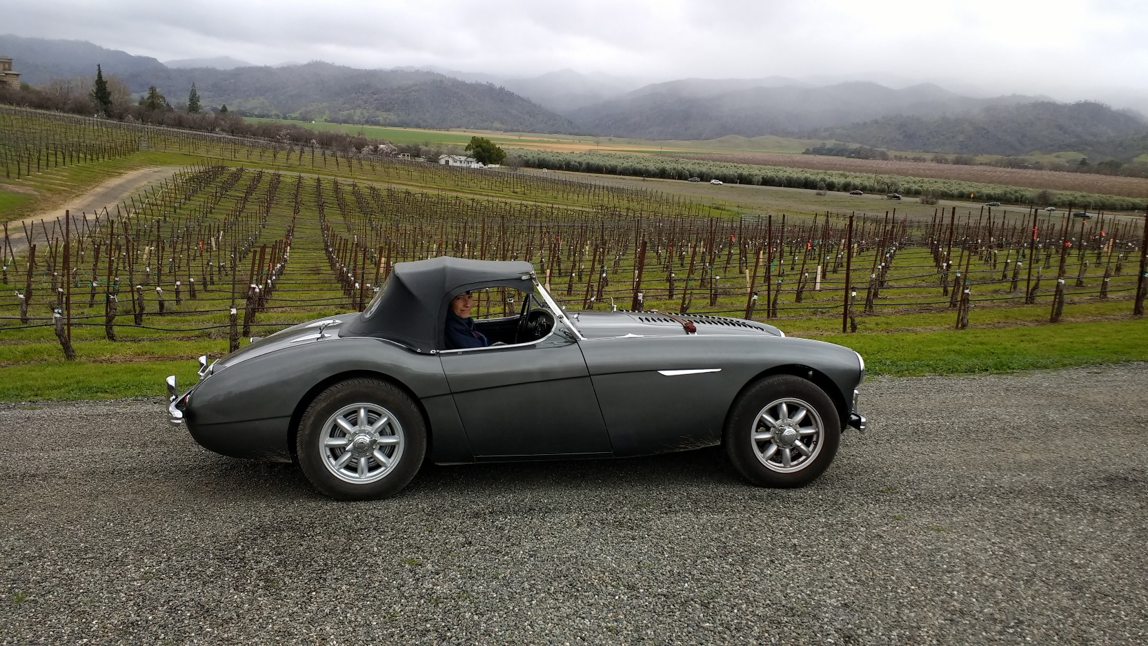

I would have researched a bit more about shooting a metallic color. I put the doors on saw horses and put the base coat on a little too heavy because I didn't have to worry so much about having a run. It's a no no with metallics as it lets the metal flakes concentrate and can make a very faint striping effect. People don't tend to notice but I do. I even bonded the doors to the paint gun and a real ground to prevent the effect. I didn't see it until I shot the clear coat. I decided it would be more fun to drive the car than to strip and repaint the doors. If you zoom in on the attached photo you can see it. I think light coats and allowing it to flash off would have been better.

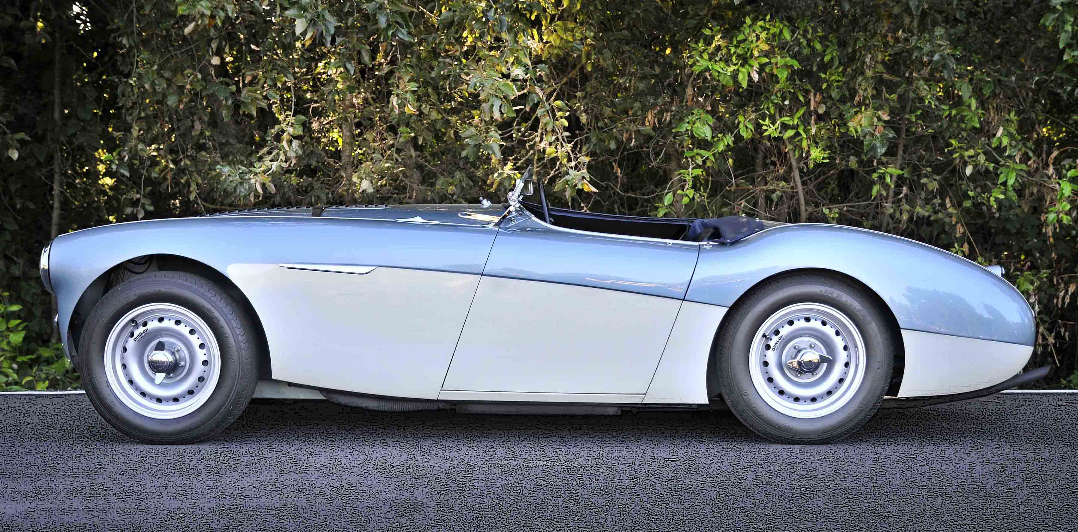

As a postscript to my earlier response, I did get a chance to sell my nicest-in-the-world 100M at my price and I took it. I slightly miss owning such a fabulous example of the marque, and one that I bought from the original owner no less, but even with 25 years ownership I never really bonded with the car and now I don't have to garage it, insure it, or worry about it. Overall, I don't miss it, and I still have my driver BN2 with Le Mans Kit, bumpers removed, AH aeroscreens and Dunlop wheels (cast repops available from Cape International), and so no regrets:

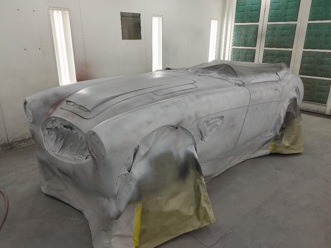

Sympathetic restoration (just what the car needs and not sweat the small stuff) is a nice goal, but a slippery slope for some of us. I intended my current build to be more of a disciplined, restrained rebuilding of only what the car needed. It is a BJ7 that was with the prior owner, a friend, for some 34 years. I'd seen it many times and "thought" I could stay on track to "do just what's needed." BUT, once you start, where to stop? Engine REALLY needed rebuilding. Interior looked every bit its 59 years age. Slight prior shunt had been poorly fixed in around 1967ish. Those issues, tied to a knowledge of who and where they could be fixed, many of them me, has taken on a multi-year full-on rotisserie build! I think for some of us, it's a DNA problem that can't be easily solved without intervention. The problem worsens when you are rebuilding something and you know how to make it better! As my buddy, with an equally unhinged car problem, frequently reminds me, "excellent is the curse of good-enough." Also, once you are on that path, there is no turning back. That said, I hope to finish this year, maybe even in time for Enclave.
