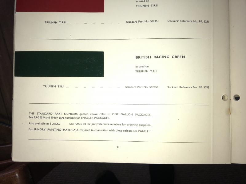

Dick:
If you are going for the original shade, I have a S-T color sample book for the TR-2 with a TR2 BRG paint sample protected by a plastic coating. Happy to loan it.
Dan

Dan, I would love to borrow it. My bodyman has done such a good job with the restoration, I want it painted the right color.
