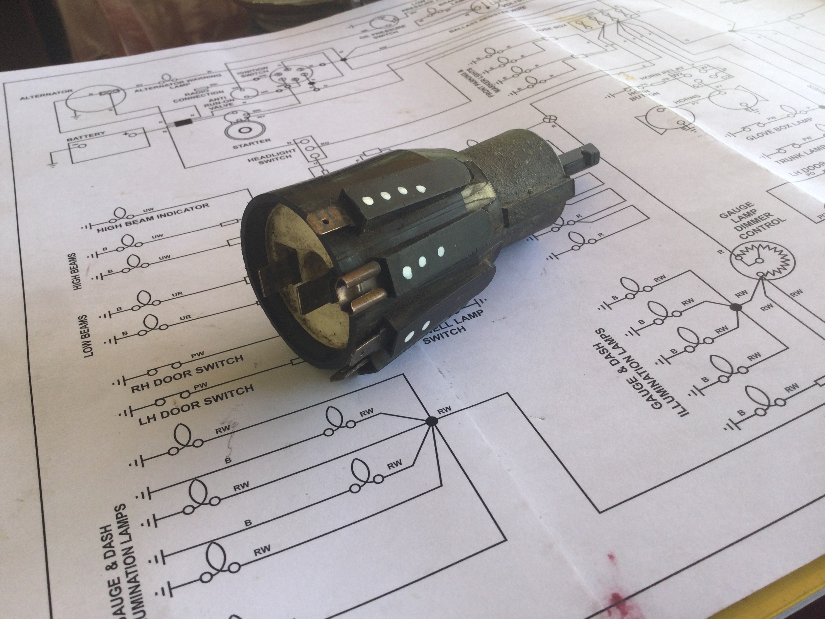

Has anyone rebuilt the original wiper switch? Or, has anyone replaced it with a nice alternative?
I’m testing the old stuff as I go through harness installation, and this doesn’t seem to work.
Shouldn’t I see continuity from the inside blade (nearest the female connector) to one of the outside male blades?

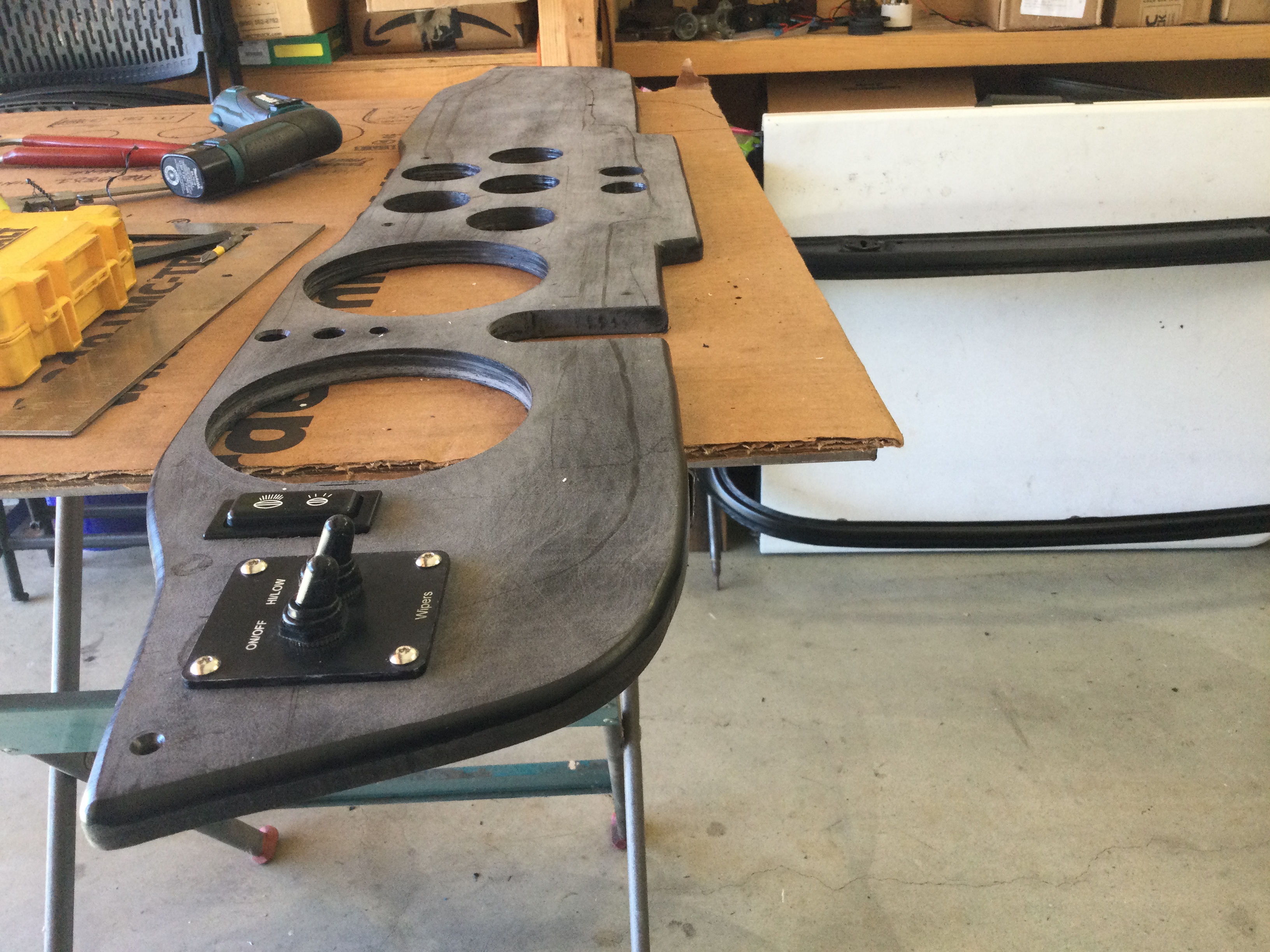

I am going with double toggle switch setup, as described in Dan Masters, sourced from wiringproducts.com...
They will put proper labels on it.

I've been able to rebuild several original switches to get normal turning force and no slipping between the metal spacer and actual switch. I pried the back off with brute force and a screwdriver, but someone else used a screw to lever the back plug out. Check this TRExp thread out and give it a shot. Unfortunately there is some risk that a 40+ year old plastic part might break.
> TR6 Wiper switch moving at dash : TR6 Tech Forum : Triumph Experience Car Forums : The Triumph Experience <
I'm not sure there is any direct replacement switch, as the low-speed brush has to be grounded in the OFF position to provide regenerative braking to keep the motor from 'coasting' past park. There was a thread on using a generic switch and 2 relays, but it was easier for me to work on the original switch. The one on my low-miles 75 TR6 is so hard to turn I'm afraid the plastic shaft is going to snap. That's my next project...

Thank you Jeff. I will try taking that old switch apart, but if my toggle switch panel ever arrives from wiringproducts.com I'm not opposed to going that route instead.
Well, once they located my order at wiringproducts.com it only took two days to get the switch panel to me... about the same timeframe as the two other orders I placed with them. So, pretty satisfied with that. Using two on/on SPDT toggles as described in Masters’ book. Still pondering what finish to put on the dash. Probably start with satin black, invoking the KISS way of doing things.
