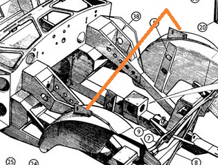

I had a rattle that sounded like a hinge or under dash or on firewall which I chased for years. Turns out the right-side fender flange had no bolt securing it to the fender. Had to remove the air hose to the blower to get to it. IIRC, at the time was able create the rattle by hitting the fender shell in the wheel well with a rubber mallet.
