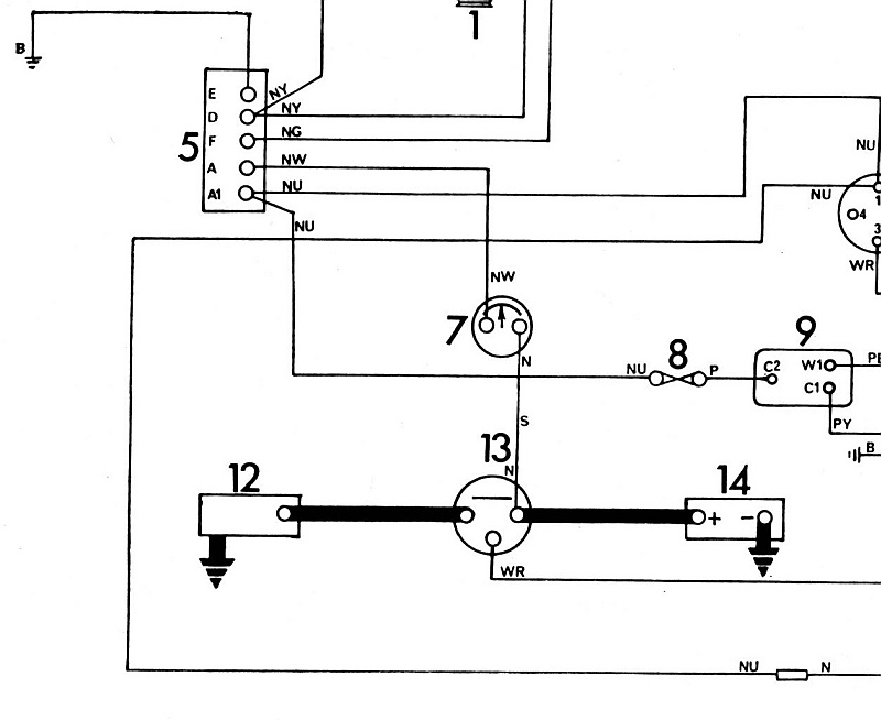

The TR4A owner's manual shows negative ground, though it's certainly possible that a mistake was made by the factory or dealer.

mmmm. Makes me wonder how mine ended up +ve. Sounds unlikely to be a factory error.
Since I don't know much about the history of my car I am beginning to wonder if at some stage parts from a TR4 were donated. With my untrained eye the car appears to be mostly original so it's anyone's guess. Anyway, I plan to switch over to -ve ground soon.
HerronScott
Both of mine which have 1966 build dates are negative ground and one is very original including still having the original helmet battery cables.
Dion, my guess is someone changed yours to positive as they had seen the same misinformation Cozmo had seen which related to the TR4. It is not difficult to swap polarity on the cars with the exception of the radio and the original Triumph radios had a polarity switch on them to accommodate the change.
