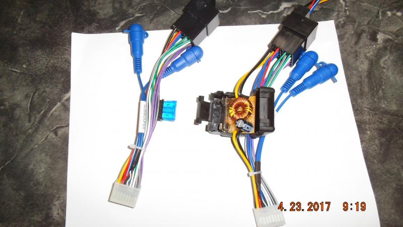

I bought a new Retrosound radio for my Tr4 and have spent a few days trying to figure out why it was not getting any power so I looked at other Retrosound radios on ebay and noticed that the main wire harness had a different fuse set up to the one I received in the box...I ordered another fuse harness that matches the ones I saw and that should have come with my radio and after some thinking I remembered the Positive Ground thingy and what I believed happened was when I ordered my radio they sent me a Positive Ground Inverter...I took 2 photos...one on the left is what I should have received and the one on the right is what I got...am I correct???Marla

Their records would no doubt show the TR4 as being positive ground; so unless you told them otherwise, I would say the one on the right is "correct" for your application.
If your car has been converted to negative ground (which is certainly the way I would go), then I think you want the one on the left.

I never said pos or neg...the ad says negative ground only and that is what I ordered...I called the shop that sold it to me and he asked if it was neg ground...but this was a couple of days later...anyway,thank you for answering this question...Marla

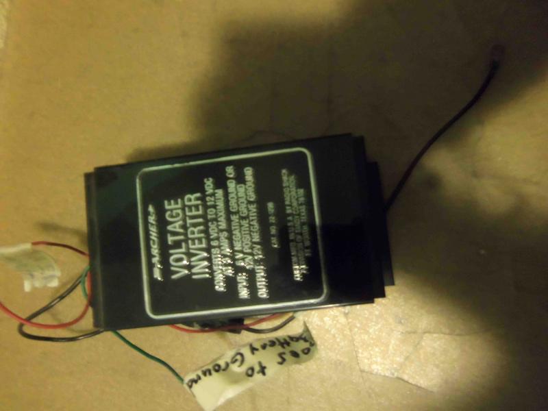

I used this for decades in my positive ground TR3. Now that I converted it to negative ground I don't have any use for it. Worked great with a modern radio.

The "thingy" on the right harness looks like a choke to me...that would be for ignition noise reduction, and nothing to do with pos/neg ground.
If you hooked a neg ground radio to a pos ground, the unit may be fried?!?

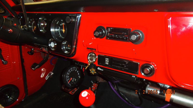

What happened was when I ordered the radio it came automatically as a positive ground where as my car is a negative ground so when it would not work I ordered a neg ground wire plug in from the company...I agree the radio is too much for the space it would occupy so I am going with the Secretaudio SST...the Retrosound I will keep as we are always buying different cars and one day I will place it in another classic...this radio is adaptable for use in all radio openings due to it's knobs ability to shift...it is a great radio so I am not taking a loss...here is a photo of a Retrosound radio I put in our 1970 C10 2 years ago...Marla
