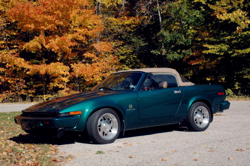

I used Woody Cooper's springs, shocks and front bearing washers. The car sits 1" lower in front. Avoiding larger speed bumps is a must. I used a spacer on top of the new rear springs to keep the rear the original height so the rear wheels won't rub on the tops of the fender arches when I pull my motorcycle camper (and I like the rake). I am very pleased with the car's handling (especially without the camper!). The wheels are old Boyd Coddington (before he had to refinance his business) billet 15".
