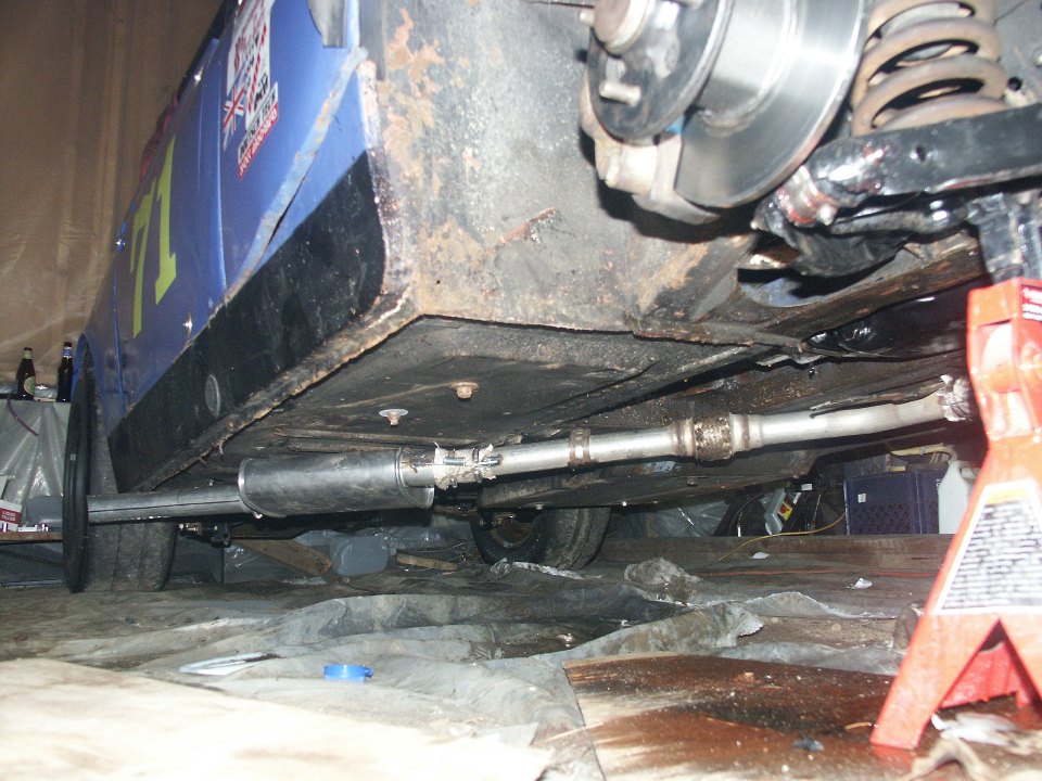

The Super Traps create too much back pressure for the noise reduction that you get in my opinion. Believe it or not but a good alternatve for a cheap muffler is the Thrush / Walker Turbo Muffler. I got mine from Summit, but you can get them anywhere. Expect to pay about $20.
https://store.summitracing.com/egnsearch....inresults=false
I don't have a link to the article but I think it was GRM that compared them and this came out near the top. I have a dropped seat pan so the exhaust comes out of a LCB header, makes a 45 under the tranny, then a spring loaded joint to the mufler and a short piece of pipe out the side in front of the RR tire. I can run the car in a garage without hearing protection.
For the track I can swap out the muffler for a straight pipe at the spring joint.

How much does this Dynomax muffler reduce your ground clearance?
Also, I already had the pipe made, so I'm looking for something short in profile. Once again, I don't really care about performance reduction at the moment.
ChrisS
It is 3-1/4" thick and I sucked it up close to the floor. If you have carpets you'll need to wrap the muffler. I'd say it hangs down from the floor 4", but only 3" or so below the bottom lip of the sill.
ChrisS
This shows it pretty good
