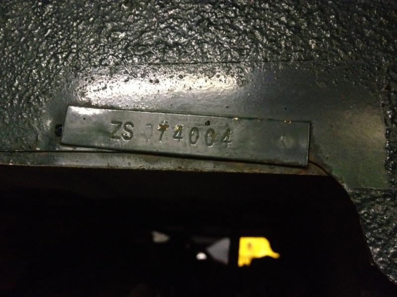

IMG_1610.jpgThis tag is in the Driver's side rear wheel wheel on my '67 TR4A is this a body number also?
Re: Is there a difference between the "Body" number and the Comission Number?
That's the "body in white" number ... applied by the body maker before paint and assembly.
It's automotive manufacturing lingo meaning when the body tub is finished being welded together and before paint is applied and any panels are bolted on. You can probably find a better description on Google or Wikipedia.
Brinkerhoff
The number welded to the left inner fender well is not related to the Body Number or Commission Number.
There is usually a similar number tag on the front frame cross member that has nothing to do with Body or Commission Number either.
