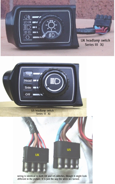

another mod you might like is converting to the UK headlamp switch, which gives you more "presets" than the US switch, such as using the Fog or Driving lights with the low or high headlamps, which the US switch does not allow.

Another great idea; guess I need to start watching eBay.
