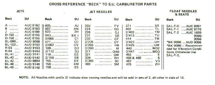

Question: the kit had needles marked "414".... needles that came out of the carbs were "TW". What the holy heck is a 414? Checked it with the vernier calipers and they seemed to be comparable, but it's bugging me. I couldn't find any info on them.

The 414 needle IS identical to a TW needle. Made by a different company. I have the whole cross reference file.

Can you share the cross reference file with us or are the copy right issues?

Brosky said:
Peter,

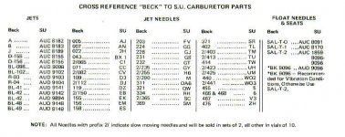

I'll try to attach a jpeg of the scannned page.
These parts were made by Jerry SAlny of Salcorp who sold to the likes of beck/Arnley, Vera, Nisonger, etc. Moss still has his kits. The old kit numbers (SAL1414, etc) were derived from the needle number (414). I used to work for Jerry back in the early 70s. We shipped a lot of these parts.
I hope the attaching process works. (it didn't last time I tried) PM me if you want a copy.
Peter C.
