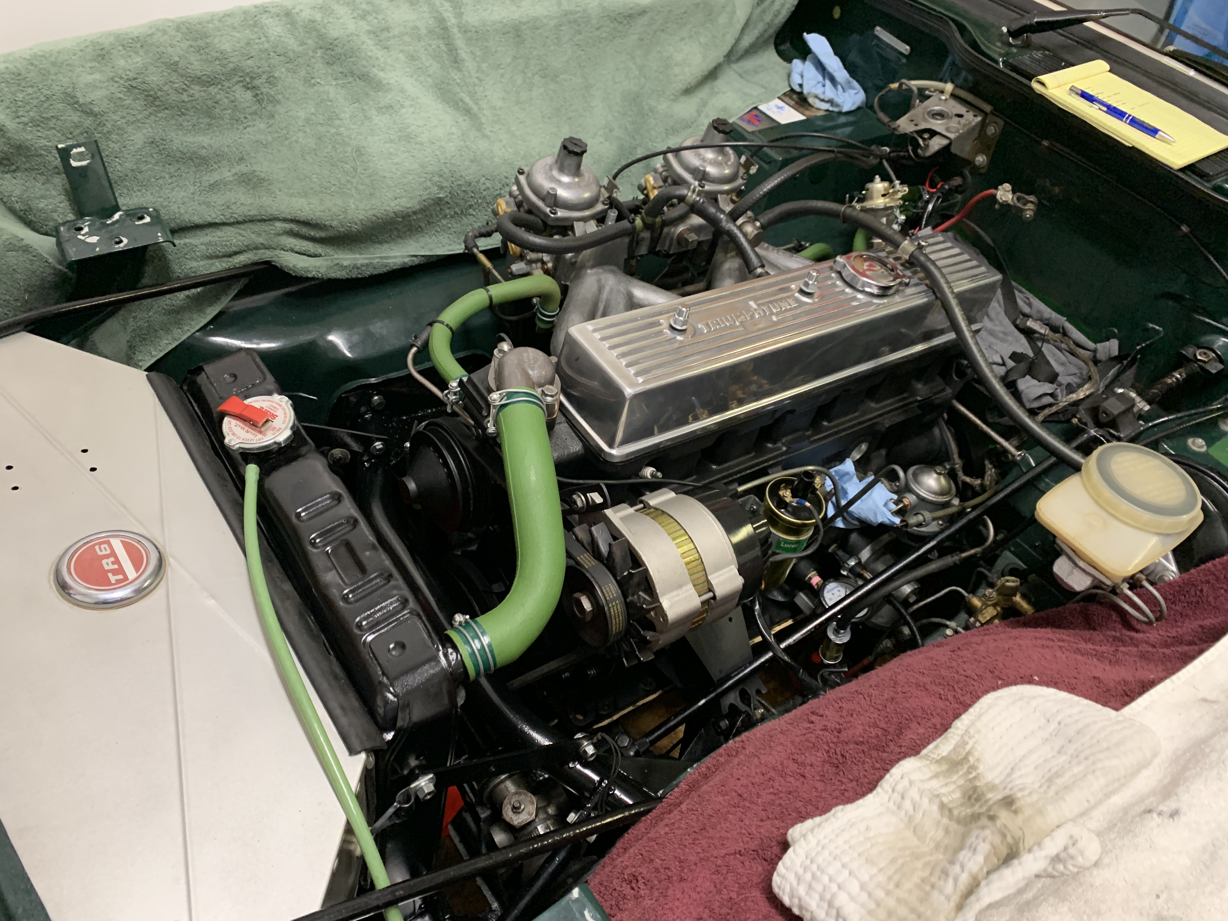

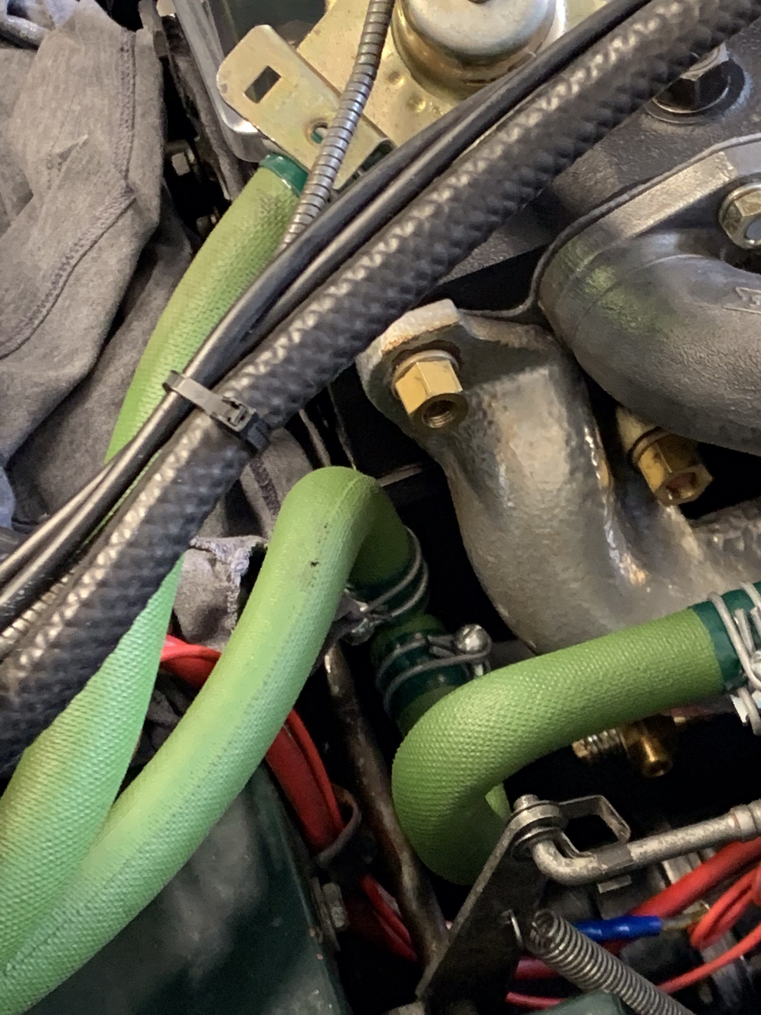

I used them in the interest in originality and found them to be variable in their tightening. I have also heard that they can cut into them if tightened too much. I wrapped the hoses underneath the clamps with green electrical tape which isn’t a great colour match but if your not really looking it’s not really noticeable.
I also sprayed the union with hairspray to help them stick on to the pipes.
I guess the taped ends are noticeable but they’re neatly done and I don’t find them visually offensive. There are other, better options but they aren’t stock…and I’ll revisit that if and when the time comes…
