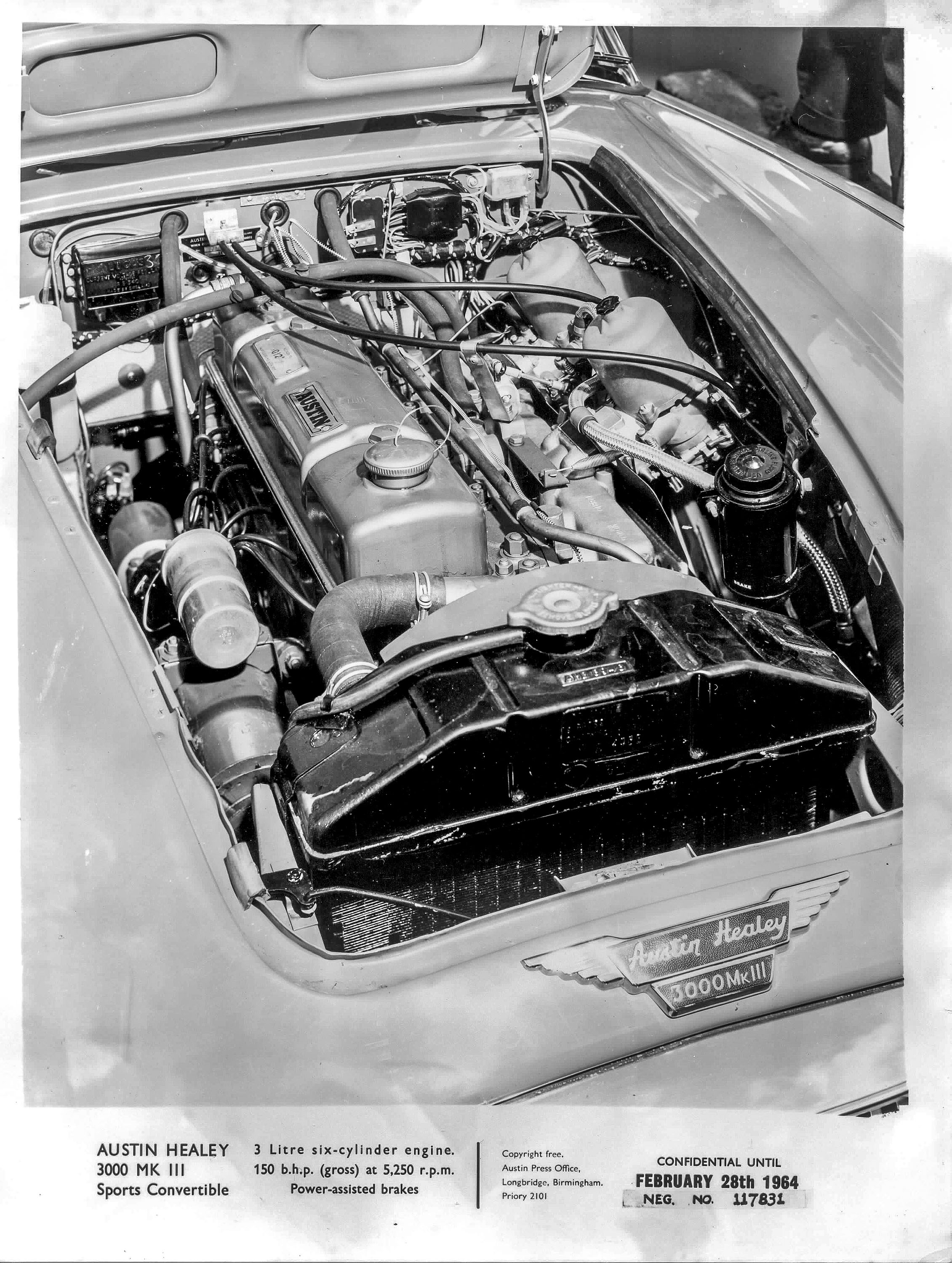

Maybe this original BMC publicity photo will help. It's of a very early BJ8 ("Phase 1," in fact):

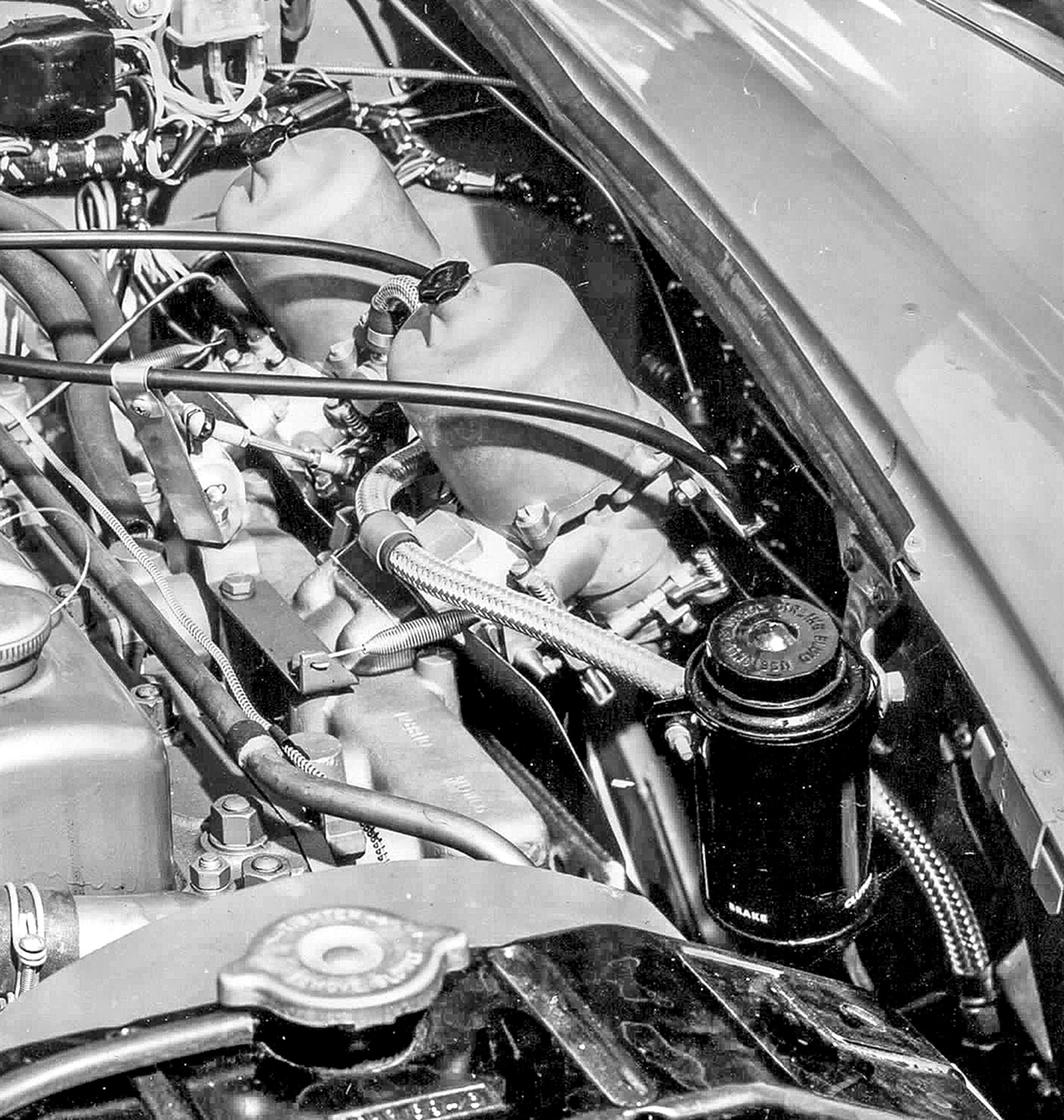

Here, below, is a close-up crop of the carbs area; it probably doesn't show anything that the photo above doesn't show, but just for fun:

I just went through the Concours Guidelines and it does not appear to indicate if the flex fuel line from the front carb is black. It says "steel" enforced. But my car has a black weave flex line (which I assume is steel enforced) that connects the two carbs. However the 20" +- flex line from my front carb is a "steel" color. [Remember from my past post] I asked Moss about this and they were unsure but noted they have seen both. Moss only has the steel color flex line. I know I have seen pictures showing that cable is black weave. I will research and get back to all with a definitive on this. Note that all (including the short one connecting both carbs) flex lines have to have the black type on yellow wrap around "Smiths Petro-Flex or ".....REGD" decals.

Fantastic find, Reid. Thanks. This picture clearly shows the flex line is "steel" color. Pardon the real dumb question, but where are the air filters hiding?

Regarding the air filters, the car may well be one of the very first examples of the BJ8 where they were still fiddling with details when a photographer from the Publicity Department showed up and they pointed him to a handy car for his assignment to get a nice snap of the engine.
Of course that's just wild speculation, but in any case I would not try to use that photo as "proof" that Phase 1 BJ8s did not have air filters - you'll lose that argument with the concours judges.

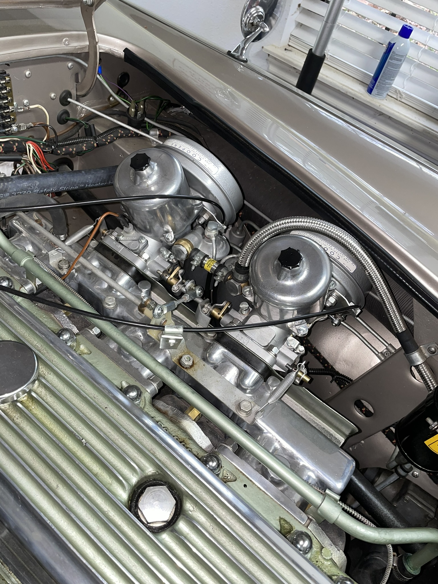

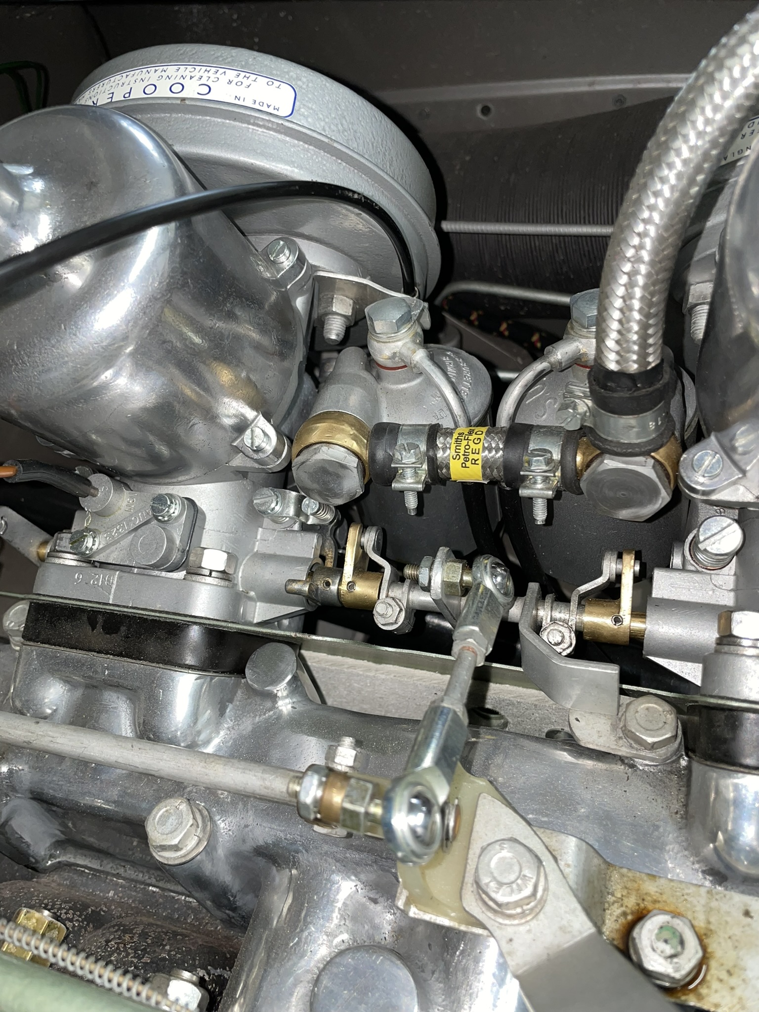

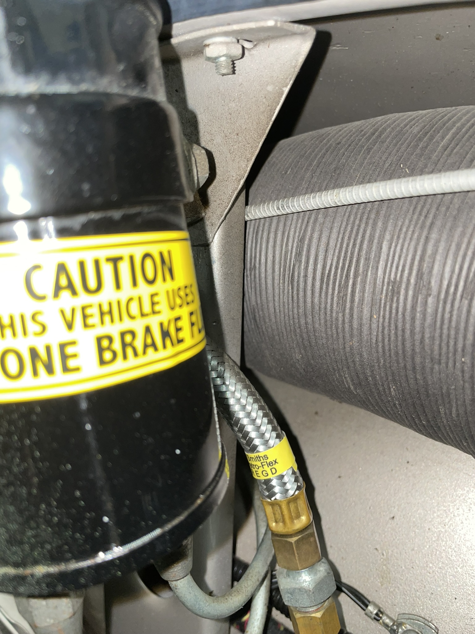

I would think that the originals were steel and the steel turned black in color afterwards. Aircraft hose is usually stainless, “Aeroquip”? The photos are of my engine bay with the decals I made attached.

Hey Patrick. I just notice your brake/clutch reservoir has the incorrect decal (per Concours). If you are interested (concours objective?), it is only to have the label "Brake" and "Clutch" on the bottom of the reservoir. IF you wish, I can give you the Moss part #.

I’m not interested in a Concours car because I have made several modifications to my Healey that are not original. However, the ones I have done were with respect to improve my Healey and could have been made in the era. I use silicone brake fluid so I added the decal to indicate so. The same for the voltage regulator being converted for alternator and “negative ground” decal. Several years ago when the Overdrive decals were not available I made my own too.
