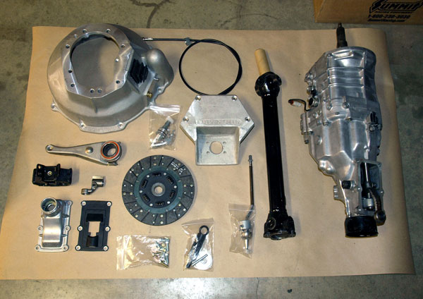

The attached picture shows everything that came with my kit (for a BJ8). The only thing in the picture that Pete didn't supply was the transmission itself.

Robert, the pictures are very helpful. You stated everything was included except the transmission. Is the bellhousing a complete new casting or is it an original Healey Bellhousing with modifications or redrilled mounting holes?
It's a new casting created specifically for this application... Healey on one side, Toyota on the other. At least that's what it looks like, anyway. Doesn't really look like the original Healey or the original Toyota. Really nice casting as well, with good looking machining work. Like everything else in the kit, I was very impressed with it!

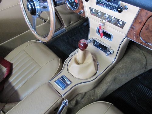

does anyone have a source for a nice looking shift boot the rubber ones just don't cut it for me any pics of what was done on a bj8 conversion with the center console
Here is a picture of my boot cover. The chrome ring is from a MG. The boot is something my wife made from a piece of vinyl.
Jerry
BJ8
BN4
