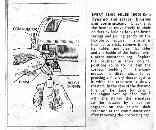

NutmegCT
Thanks Lou. Right now, I'm betting the generator brushes need replacing. Brushes are on page 55 of your operation manual. Not a difficult job -
You can get new brushes from Moss Motors, or many other online sources. And you've probably got a "electrical starter and generator" repair shop within fifty miles of where you live.
When you say the ammeter did move a lot when you tried the lights on/off thing, it's probably ok, but may be wired for positive, not negative ground.
Hope this helps.

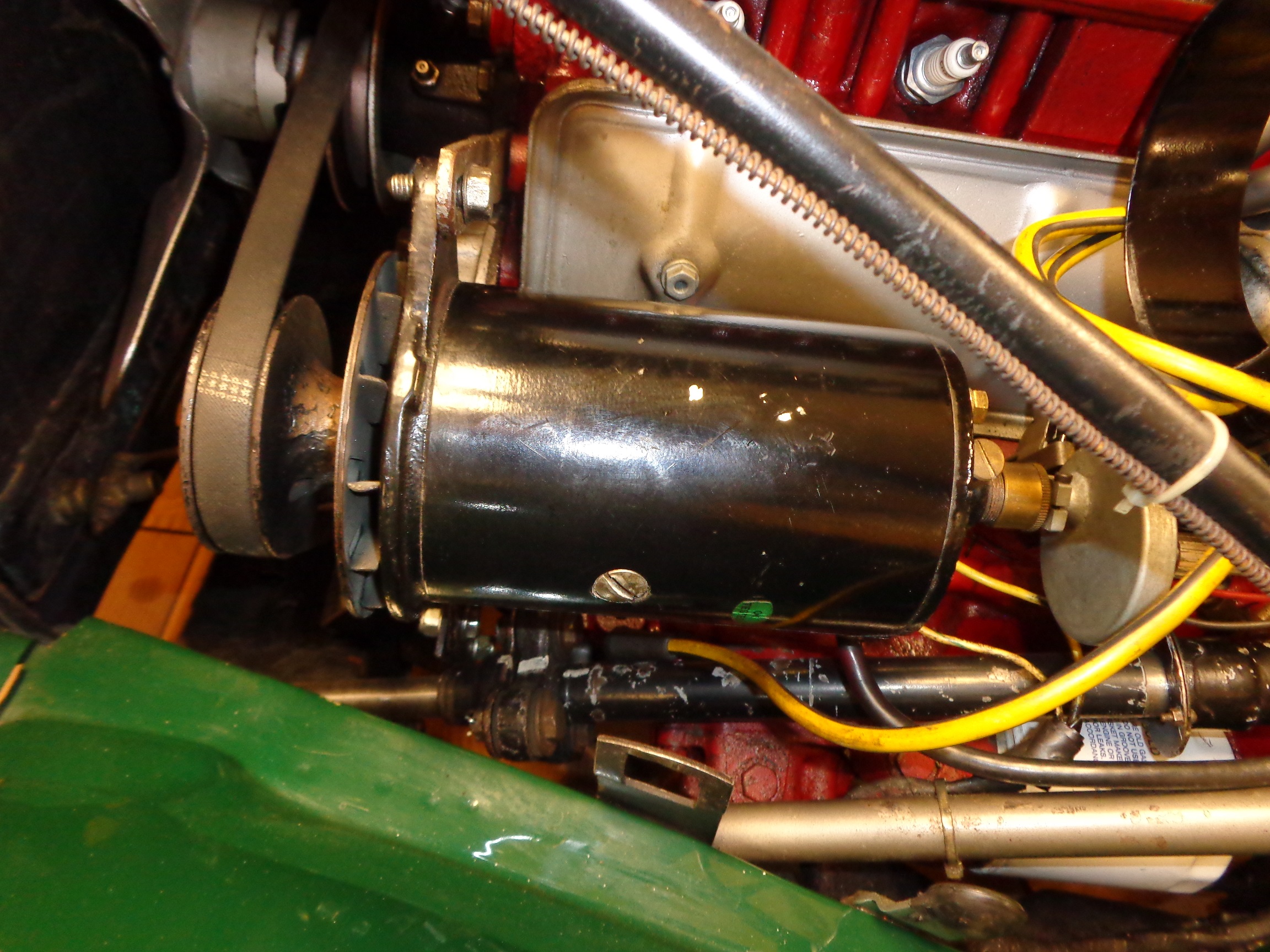

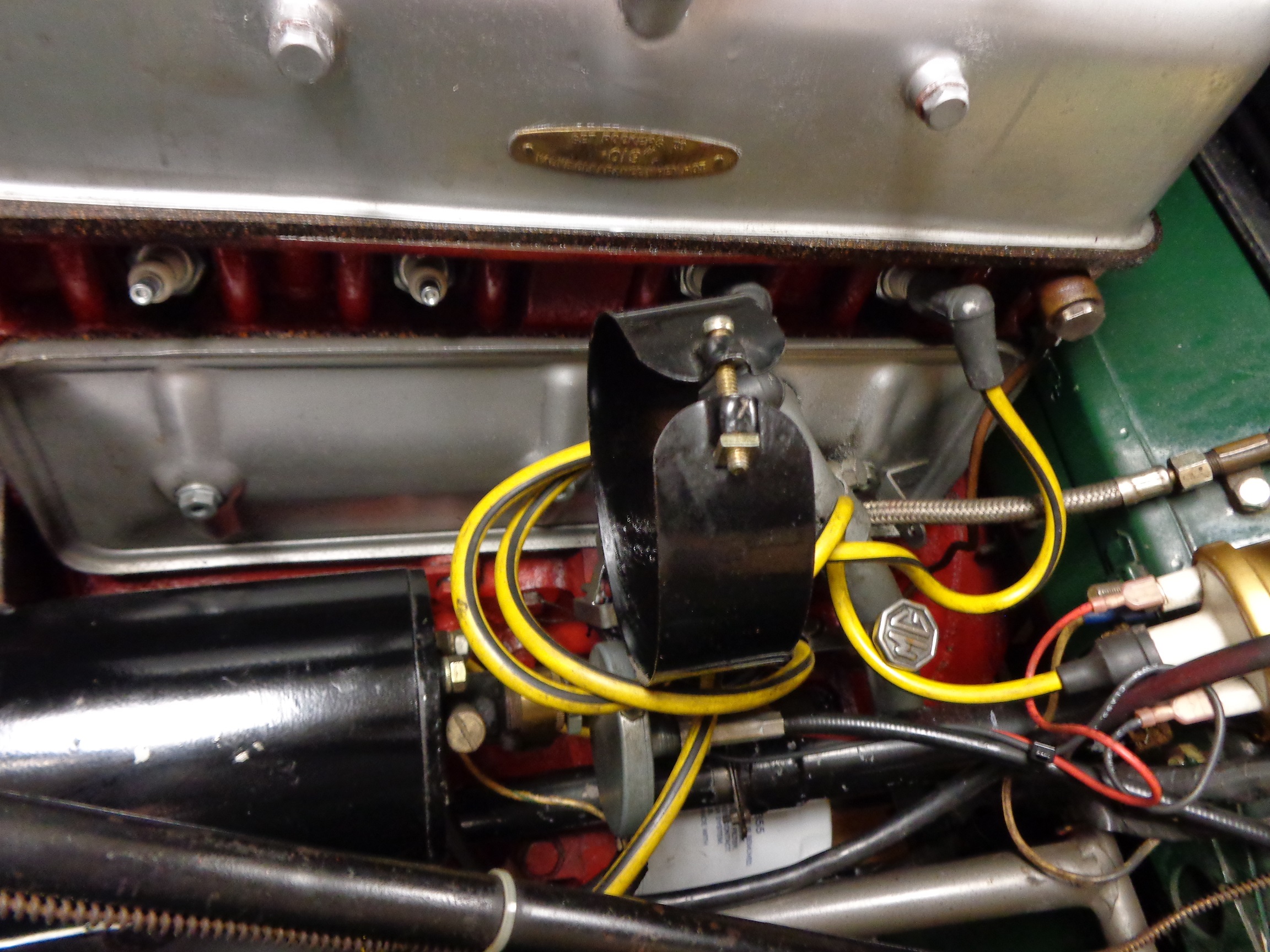

Louis 52MGTD
Tom,
I removed the insp. clamp to check the brushes, no insp. hole ? maybe a more modern gen ? I guess the clamp was left on for looks ?
Here's a few pic's, but it does take the tach. hook up.
I guess I'll just have to pull it off and take it to a gen. repair shop.

NutmegCT
If you've not opened up a generator before, I think a trip to the generator shop would be the next step. At least then you'd know if it has a problem, and you'd have someone to fix it while you wait if needed.
Tom M.

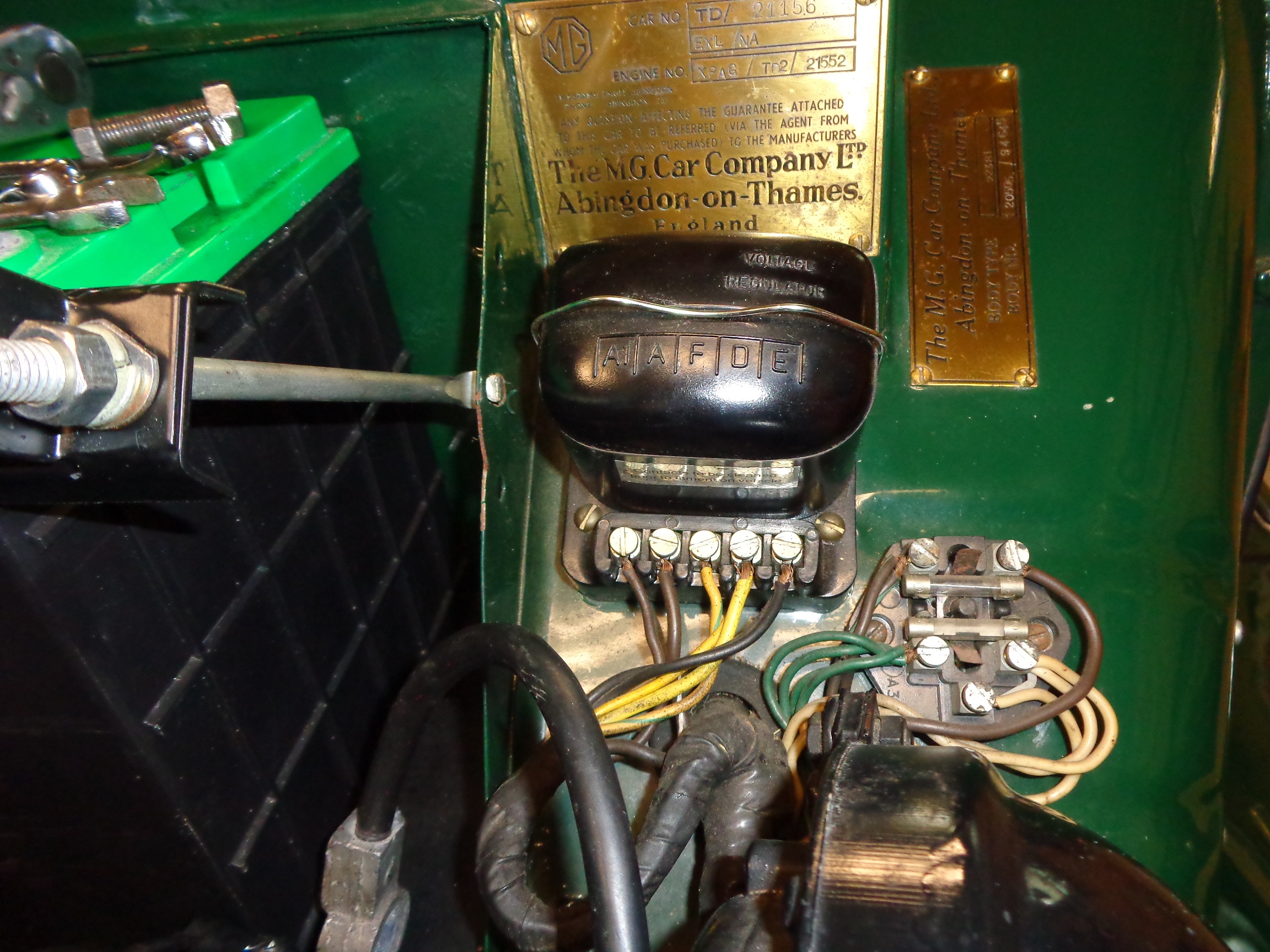

Louis 52MGTD
I just gave up on getting my bad gen. fixed, the gen. shop could not find the right parts so I ordered a gen. from Moss.
The told me I would have to polarize the new gen. anyone know which of these post on the reg. I need to jump for a second ? the car is a neg. ground. thanks for any help. Louis.
