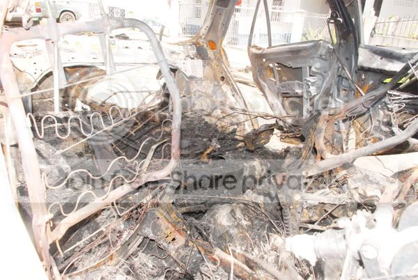

I have a fire extinguisher, but I dont think its large enough to put out any substantial fire....
:shocked:
--WOT !
Then get a larger one it can save your day.--Keoke- :yesnod:
My take is that for any 'substantial' fire, you should worry first about getting out any valuables (SO, etc.) then break out the marshmallows. No portable fire extinguisher is a match for 10 gallons of fuel (plus a gallon of oil). And the odds of saving the car at that point are slim, whether the fire is put out early or not.
In nearly 40 years of tinkering with old cars, I've needed an extinguisher exactly once. It turned out to be a total waste of time; I put the fire out with the garden hose instead.
It's hard to remember in the heat of the moment that dry chemical extinguishers must be used only in the upright position, especially when the battery is on fire and already burned through the hood release cable!
And before someone jumps on me, I'm kidding about the marshmallows. Those explosions you see on TV are pure nonsense (unless you just happen to have a trunk full of high explosives), but small ones are quite possible. And I'd much rather lose the car than take a bath in burning fuel or battery acid. Stand well back while it burns.
<span style="font-size: 14pt"><span style="font-weight: bold">let the sucka' burn!</span></span>
